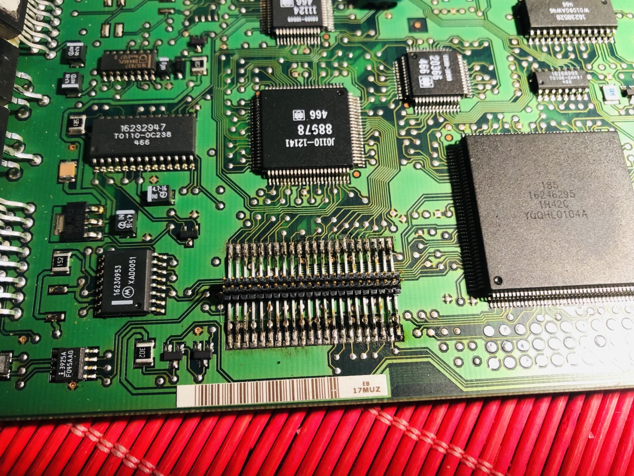

Yes it is mate. I have it hooked up to a bench harness and power supply

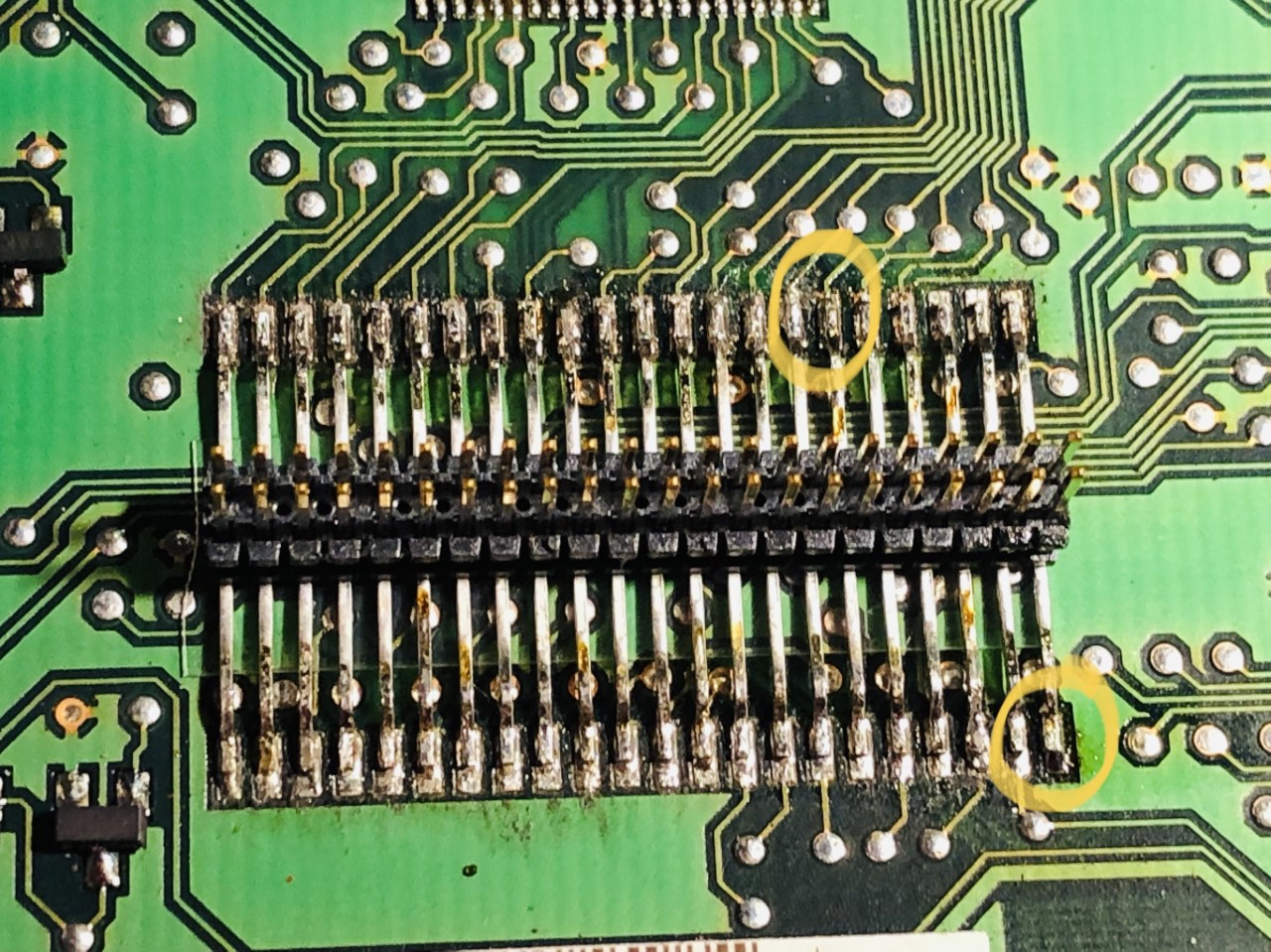

Any thoughts?
Fixed.
went over the RR header with a magnifying glass and a meter. found a crack/break in one of the tracks where its soldered to the PCB :hihi:

Yes mate….sure did
Reckon the pressure of the USB cable on the on board USB socket was twisting the RR header which cracked the track.
Just a tip for you guys who solder small distant spaces like this as well as micros. Solder all 4 corners so the device won't move in the next step. Solder/short the entire connection, do it fast when soldering a micro and let it cool. Heat and drag solder wick soaked in rosin/flux across the terminals to suck up all the extra solder. Practice on something you don't care about if unsure.
When finished, it will look like a machine soldered it.
