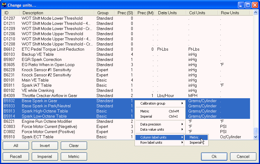

    If EFILive is installed on a PC with the Windows regional settings as "English - (United States)", the default units will be Imperial. This means that calibrations such as the spark maps will be displayed with the air flow labels displayed in Oz/Cylinder rather than the preferred units of Grams/Cylinder.
    EFILive provides a way to customize the units used to display the calibration data, the column labels and the row labels.
    For example, to change all calibrations from Oz/Cylinder to Grams/Cylinder, perform the following steps:
    1. Make sure all calibration windows are closed, if they are not, then you will be prompted to close them.
    2. Select the menu option: "Edit->Configure display units...". Be patient, it can take a few seconds to load all the calibrations' display units and precision information.
    3. Click on the header labelled "Column units". That will sort the list so that all calibrations that use Oz/cylinder will appear together in the list.
    Note: you can adjust the column widths of the display by dragging or double clicking the vertical column-separator bars in the header.
    4. Select all the calibrations that have Oz/Cylinder specified in the "Column Units" column. You can select multiple rows by clicking on the first item, then hold the shift and click on the last item.
    5. Right click on any one of the selected rows and select "Column label units->Metric" to change the Oz/Cylinder units to Grams/Cylinder units. See image below.
    6. Repeat steps 3 to 5 for the "Row units" column.
    7. Click OK
    Note: Clicking on the buttons at the bottom marked [Imperial] and [Metric] will instantly change ALL calibrations and all rows and columns to Metric or Imperial - whether they are selected or not.

    In scantool PIDs tab, right click on each pid and select metric or imperial.
    In tunetool Edit->Configure Display Units, set units of any table that references those pids to the same units as in the scantool (set data units, column units, row units); click OK when done (see post #1).
    Is this what you did...?

    Under Edit->Configure Display Units, click on each of the headings "Data Units", "Column Units" and "Row Units";
    for each one of those headings, clicking on it sorts/groups units alphabetically;
    you can then highlight the group of rows having the "wrong" version of a unit,
    right click and set it to the "right" version (e.g. imperial to metric);
    do this for each heading so that you have consistent units thru-out.
    For example, find all occurances of "oz/cyl" and change them (as a group) to "grams/cyl"...
    make sure to do this under each of the 3 headings (some units do not appear under all 3 headings).
