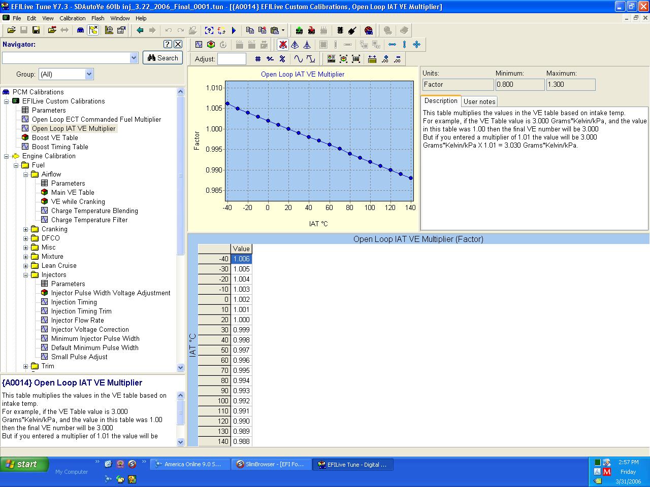

    Default Show me your A0014's
    As the title suggest, I just want to see if I am on the same track as others on here.
    Heres mine
    http://www.angermanagementracing.com...rary/A0014.JPG

    Mine is the total reverse of that one. Using a Over radiator cai - i have about
    0.96 at 10deg C
    0.98 at 20deg C
    1.00 at 30deg C
    1.04 at 40deg C
    1.08 at 50 deg C
    It seems weird but its working!

    Mine is same as flyer pretty much. Again, not sure why. Maybe the charge blend table is out of whack and the backwards A00014 fixes it?
    Will investigate more in a few weeks when my dart heads and cam are on

    I too change like Flyer does

    Yea, I guess i was going the wrong way. My assumtion was that I needed more fuel with lower IAT's. I guess the assumption is right, but the application is wrong.
    I know EFILive is coming out with a new OS that will address this after LS2/7 support, are they having it work the opposite way like stated here, or is it going off theory, and not whats seen in the real world?

    I have been testing with this table a bit lately and this is what I have found works for me:
    In another thread Paul (Blacky) posted a spreadsheet that attempted to calculate (I guess with scientific basis) what the values should be. It had many columns to allow you to define at which IAT temp is your 1.0 factor and then scale the rest of the table appropriately. The results seemed to be in contrast what what people (me included) are seeing.
    In my previous testing I have found the same results as Flyer and ringram (where the factor increases as the IAT increases).
    This last test what I decided to do is reverse the values in the spreadsheet that Paul produced. This seems to be pretty much spot on IMO.
    So my table scaled so that an IAT of 30*C is 1.00 looks like:
    LABELS IAT VE Multiplier (Multiplier)
    IAT °C {link: SAE.IAT} Value
    -40 0.911377
    -30 0.922607
    -20 0.934082
    -10 0.946289
    0 0.958984
    10 0.972168
    20 0.985596
    30 1.000000
    40 1.014892
    50 1.030517
    60 1.046875
    70 1.063965
    80 1.081787
    90 1.100830
    100 1.120849
    110 1.141846
    120 1.164307
    130 1.187988
    140 1.213135

    Yes, that is backwards, most have found the hotter the intake temp it leans out, esp at idle, low throttle. I found the charge table didn't seem to help the problem either.......oh, this is running full open loop, no O2 feedback at all.
