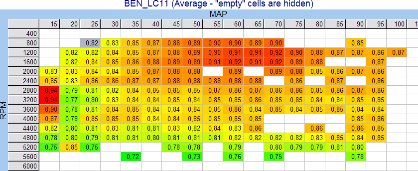

    OK, here's my result from the AutoVE-run ... took a nice long spin, was able to hit most of the cells on the BEN-map (based on the Backup VE) up to 6000rpm ... the NB O2 seem to be partly a bit off, but most of the KR is gone with the 15% increase on the base VE values ... anyway, most of the BEN cells are in the 0.85 area - which seems to mean that the correction of the VE table would then remove the 15% increase ...
    Any comments on this data??
    Garry,
    This means you can richen your PE vs RPM and/or enable PE at a lower RPM; you can enable PE concurrently with AutoVE tuning in your case (you still want to get BEN's to 1.00 +/-0.02 or better).
    It works easier if you post screenshots of your BEN map and chart log
    (I couldn't find the right WB AFR pid so I couldn't see you BEN's).

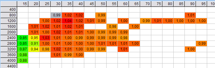

    Here's the BEN map ... I did the run with the backup columns, so after filtering out and removing the cells with less than 15 values, this is what I got on the more detailed MainVE overview ...
    I modified based on the BEN, then smoothed out the untouched cells ... headin' out for another short testrun .. see how she feels ...

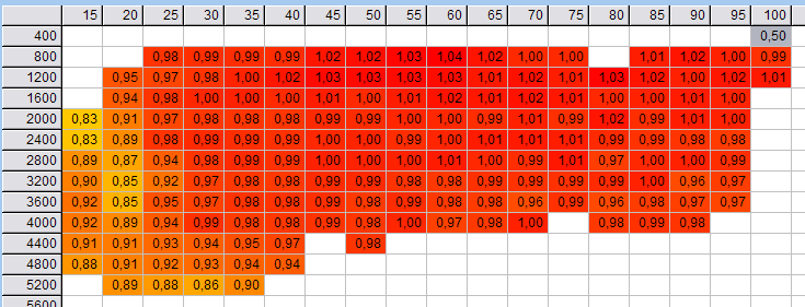

    Looks like I'm getting there ... after the first modified tune, most of the BEN cells ended up pretty close to 1.0 ... after I filled most the cells, I did another reflash and logged the rest of the way home ... couple of low MAP values resulted in some <1.0 values, which I just reprogrammed again ...
    Still have some occasional KR, though it seems to have reduced some ... any idea, or is this more or less "normal"?

    Almost... in normal driving in OL the PCM is using the EQ from the OLFA table (which is 1.00 in most of this area; EQ 1.00 is AFR 14.63); and when TPS hits or exceeds the PE enable curve B3616, the PCM uses the richer of PE B3618 or OLFA B3605; see pic: OLFA normal driving is flat EQ 1.0, OLFA high MAP region is red circles, PE is green circles; the second red circle is because the OLFA is richer at that MAP than the PE is at that RPM (OLFA was 1.130, PE was 1.122; I have since richened my PE curve which is shown in post 37 above).
