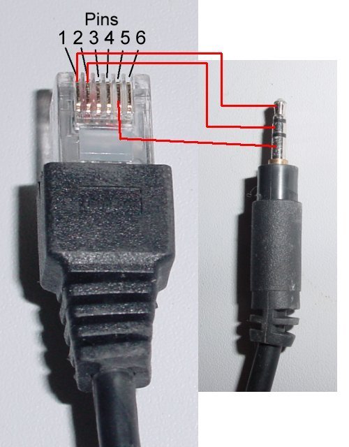

    Diagram showing the various cables and pin-outs required to connect FlashScan to an Innovate LC-1 or LM-1 Wide band controller.
    For those that want a simple cable solution, you can wire up an RJ12 plug directly to the 3 pin jack as follows:
    Code:
    RJ12    Jack
     1 <---> 1 (tip)
     2 <---> 2 (middle)
     5 <---> 3 (base)

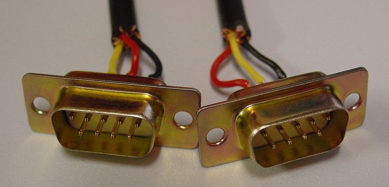

    The null modem connector can be purchased here:
    http://www.sfcable.com/cable/p/30D1-C1-S.html
    If you want to make your own male-male null modem cable, see images below.
    (Ok, so the soldering could be better, I'm just a programmer. Beware the programmer wielding a soldering iron...)

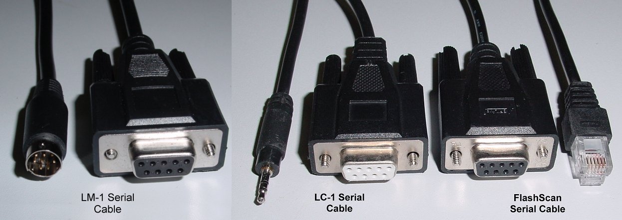

    For those of you that can't locate your LC-1, LM-1 and/or FlashScan serial cables, this is what they look like.
