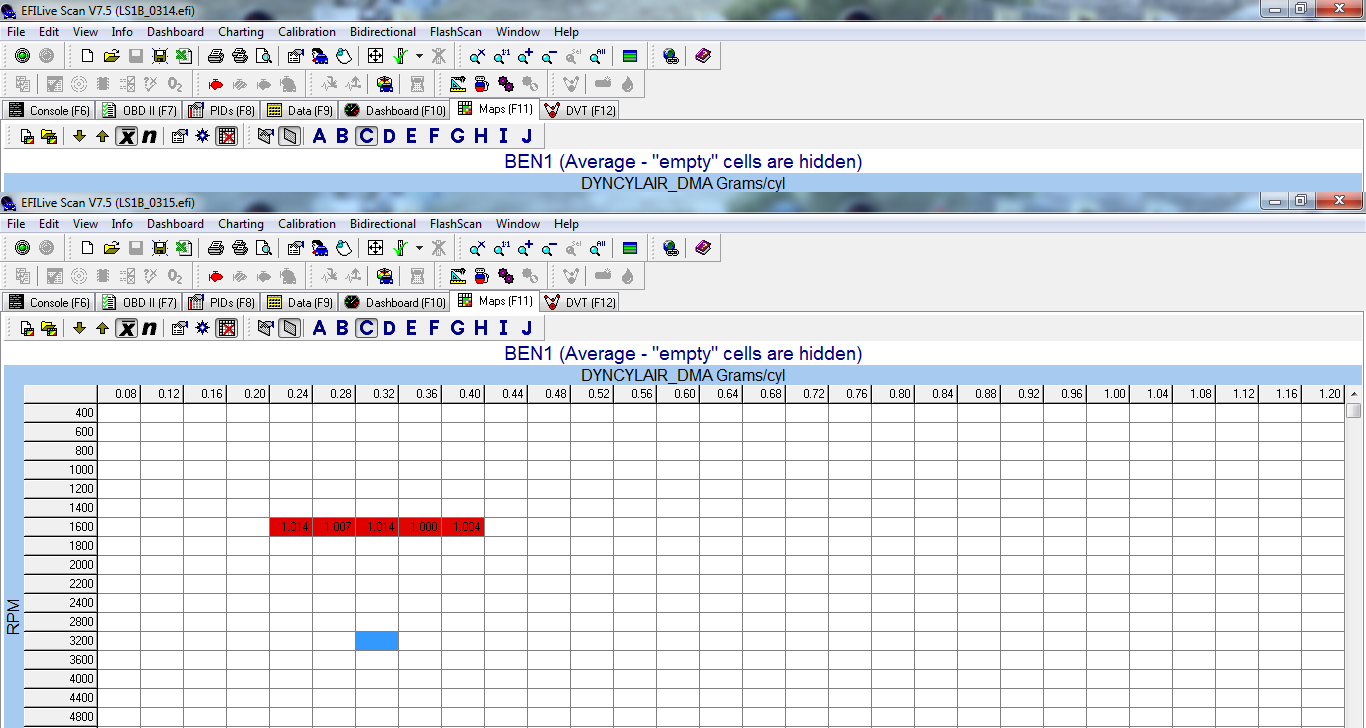

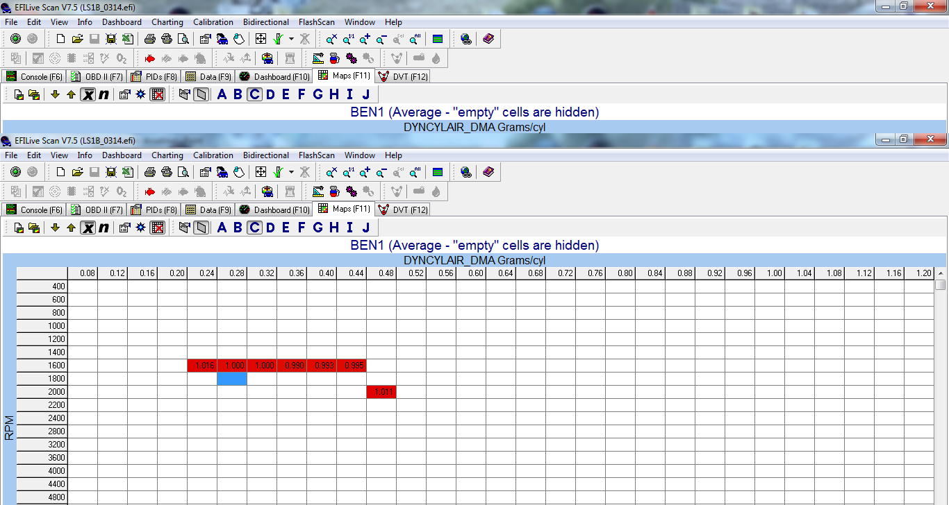

Fuel trims in Lean Cruise
I had been seeing ltft showing up during lc and I wasn't sure if they were actually affecting the mixture or if the computer was just ignoring the fuel trims. Tonight I logged a stretch of road and attached are the logs. I filtered both logs and compared the bens of each log with each other. Let me know what you guys think. Its less than a 5% difference but to me it seems like there is a correlation.
in each log i started ate the startpoint and drove, then turned around and came back to the starting position.
Attachment 12445
Attachment 12446
