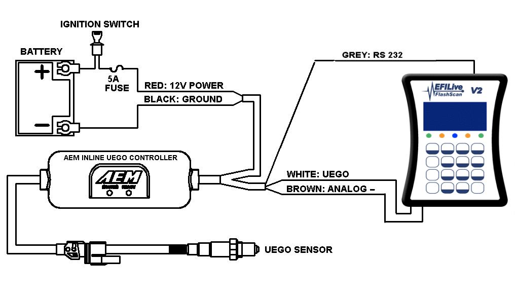

trying to hook up my AEM UEGO wideband into my buddies FlashScan V2 so we can log the wideband's output. I've read a bit and wanted to verify before making cables/blowing anything up.
Alright, so, from the AEM gauge, I'm going to run the blue cable (serial output "Connects to a RS-232 com port for hyper-terminal data logging") to pin 2 on a DB9 serial connector. The gauge already has power/ground.
Now, the FlashScan V2 serial cable (seen here) has a female end. Am I right to think that I can simply wire the blue wire into pin 2 of a male serial cable, connect this to his FlashScan DB9 to RJ12 adapter, into the FlashScan handheld, and then have logging capabilities?
If I'm incorrect, please let me know. Need to iron out some part throttle/idle stuff so I stop getting 11MPG in a cam-only 2940lb car :grin:

30-2310 aem uego controller
According to the instructions that were posted:
PHP Code:
The grey wire from the UEGO Controller outputs the data stream in an RS232 serial format.
To connect to the pc/laptop, an RS-232 DB-9 connector is recommended.
The grey wire from the UEGO Controller goes to pin 2 of the RS-232 DB-9 connector.
Pin 5 of the connector goes to ground. See Figure 5.
Attachment 10449
