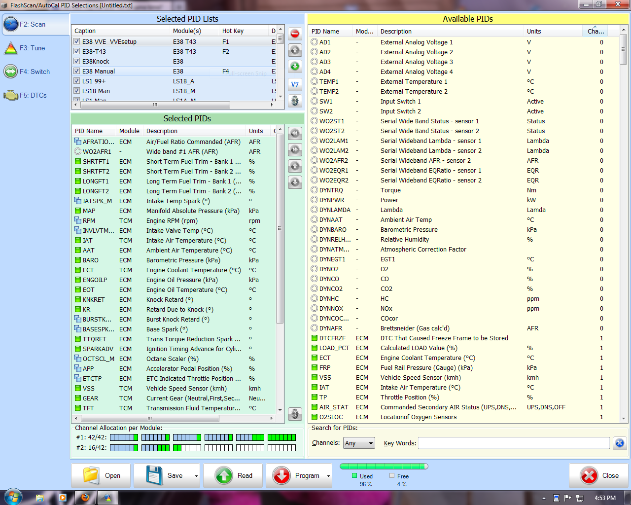

BBL (V2) only.
PIDs cannot have the same name (e.g. VSS) - cannot log ECM VSS and TCM VSS at the same time. I believe once V8 is fully rolled out, the PIDs will be renamed / realigned such that this restriction will be lifted.Quote:
... Any special trick? ...
Regards,
Taz
Thank you
Also if you look through your PID list on the BBx setup there is a lot of stuff you can log via the TCM instead of filling up your ECM list. I am logging coolant, intake temps and RPM just to name a few :D
Attachment 12995
Here is a copy of my PID lists Attachment 13027
Save that to EFILive/V8/tmp and you should be able to open it up in the BBX tab :)
