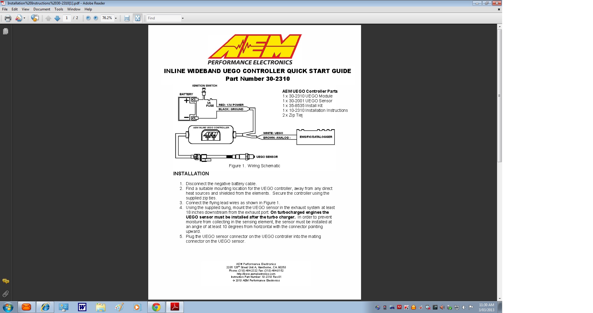

im trying to connect the 30-2310 in a friends car to my v2
i have the RJ12 phone plug 6p6c . which wire from the AEM goes to what pin on the v2 ( rj12 plug )
there's only a gray , white, and a brown coming from the AEM unit
Attachment 14672

hi jo
it doesn't have a black wire ?? only brown/white /gray
thanks
Try it without the ground wire and see what happens.

NO we couldn't get any one of the 3 units to work with serial ,( NOT FOUND ) we bought techedge 2J9 units instead they come with a proper cable ( if you ask for it ) with a RJ45 plug one end to just plug in to the TECHEDGE UNIT
and RJ12 plug on the other end to plug in to the top of efilive v2 unit in the RS232 SOCKET :rotflmao: JUST MAKES IT PLUG AND PLAY
I have had the same problem, I am buying another brand!
i don't know of anybody that has got the 30-2310 to work with a v2 ,the 30-4100 ( the one with a gage ) seams to , i got one to work about 2 years ago
