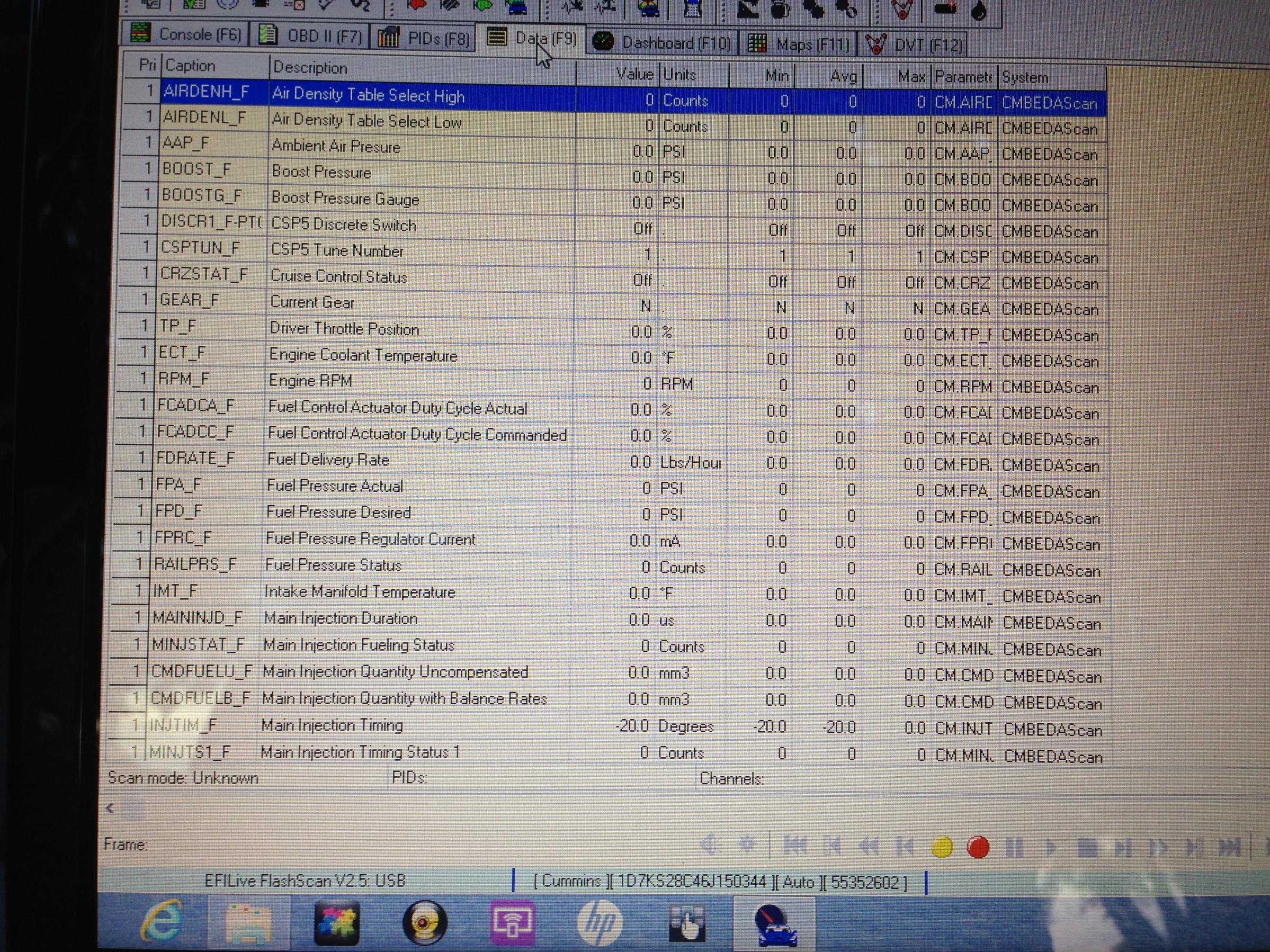

My truck has Csp5 installed and I use v2 to switch tunes that works and I have verified that. In v8 I checked the box to reload previous pid group the named my tunes selected CMB pid list per the guide clicked and drug the pid sub folder EDA1 to the box on the left per the guide and selected program all. initially got a "write failure" error code but after formatting it programmed all. Then it would switch tunes and everything but the only time I can select the EDA Pid group in v7 scan tool is if I uncheck the box for supported then I can select EDA but all pids are invalid. This is with v2 connected to truck with csp5 and laptop before starting v7. I did load the tune in the truck befor configuring v2 for eda and haven't flashed since

I clicked on the validate pids icon and bingo it worked otherwise would not allow me to select. I guess I was just spoiled with the software always doing it for me!Attachment 15582Attachment 15582
