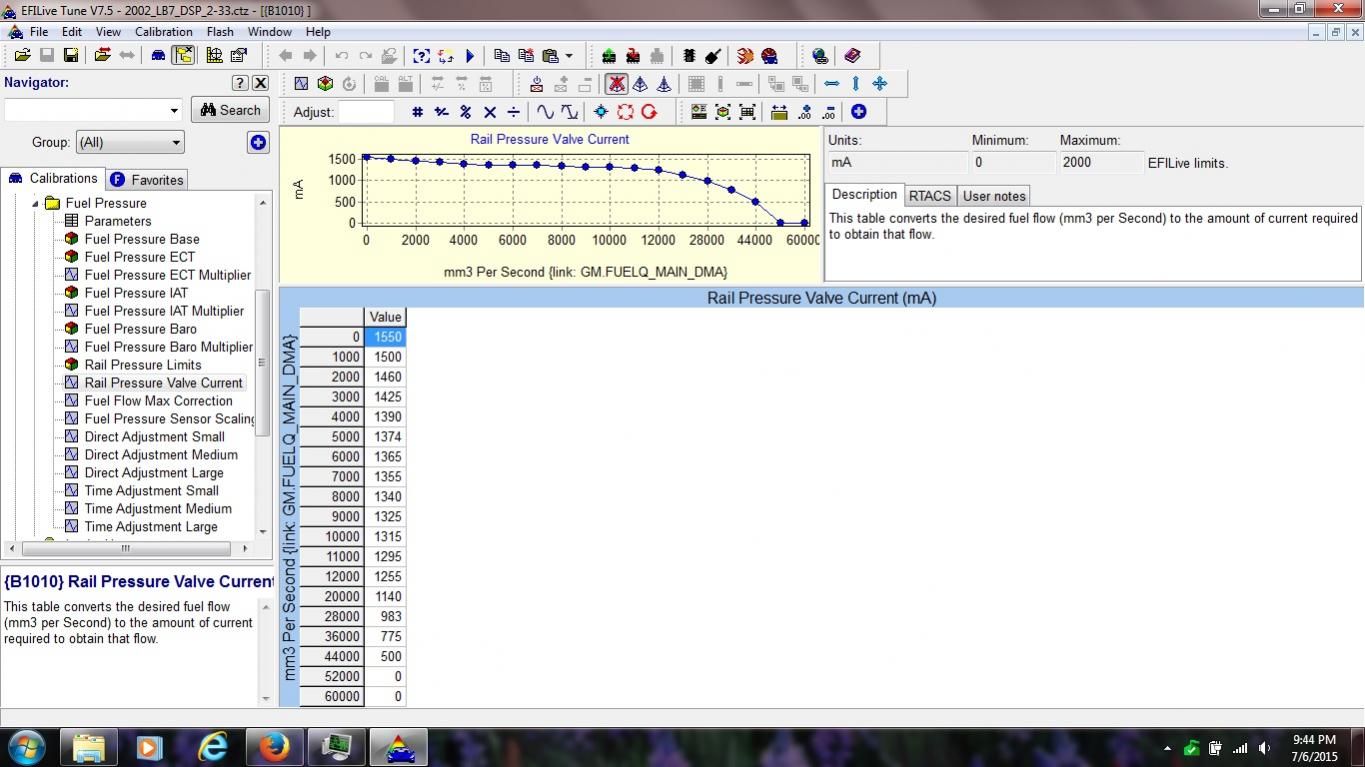

You will need to rescale the LLY FPR current conversion table to mimick an LBZ. Open up a stock LBZ file and compare the tables. It is not a direct copy, you will have to do a little math to make the LLY map resemble the LBZ map. It will likely take you a few attempts to get it smoothed out and even then you may still have some rough spots here and there.
Heres what I used in my LB7. I tried plotting the two against each other, and had several spots where desired didn't match actual, so I came up with this table. I do run a 2250 pulsewidth though, so the upper ranges of mine will be a good bit lower than a stock truck.
Attachment 19188
Basically add 13% to your lb7 reg curve and should be pretty close.
