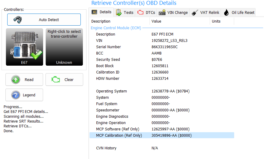

I have a customers vehicle here which has a GM Chevy Performance Crate motor, E67 ECU and loom in it. This is all running fine and has been for years.
What I have been asked to do is remove the auto (Nissan RE4) currently behind the LS3 and install a 6L80E, which has been all done and installed.
Now I'm up to the wiring and programming/setup of the T43 and E67 to work together. I have the wiring all sorted but I'm not sure if the OS on the E67 will work with the T43. Below is a screen shot of the E67 details:
Attachment 24556
Apparently the T43 has been pre set to work with this E67.
Does anyone have a stock cal file for the above E67 LS3 for use with an auto?
