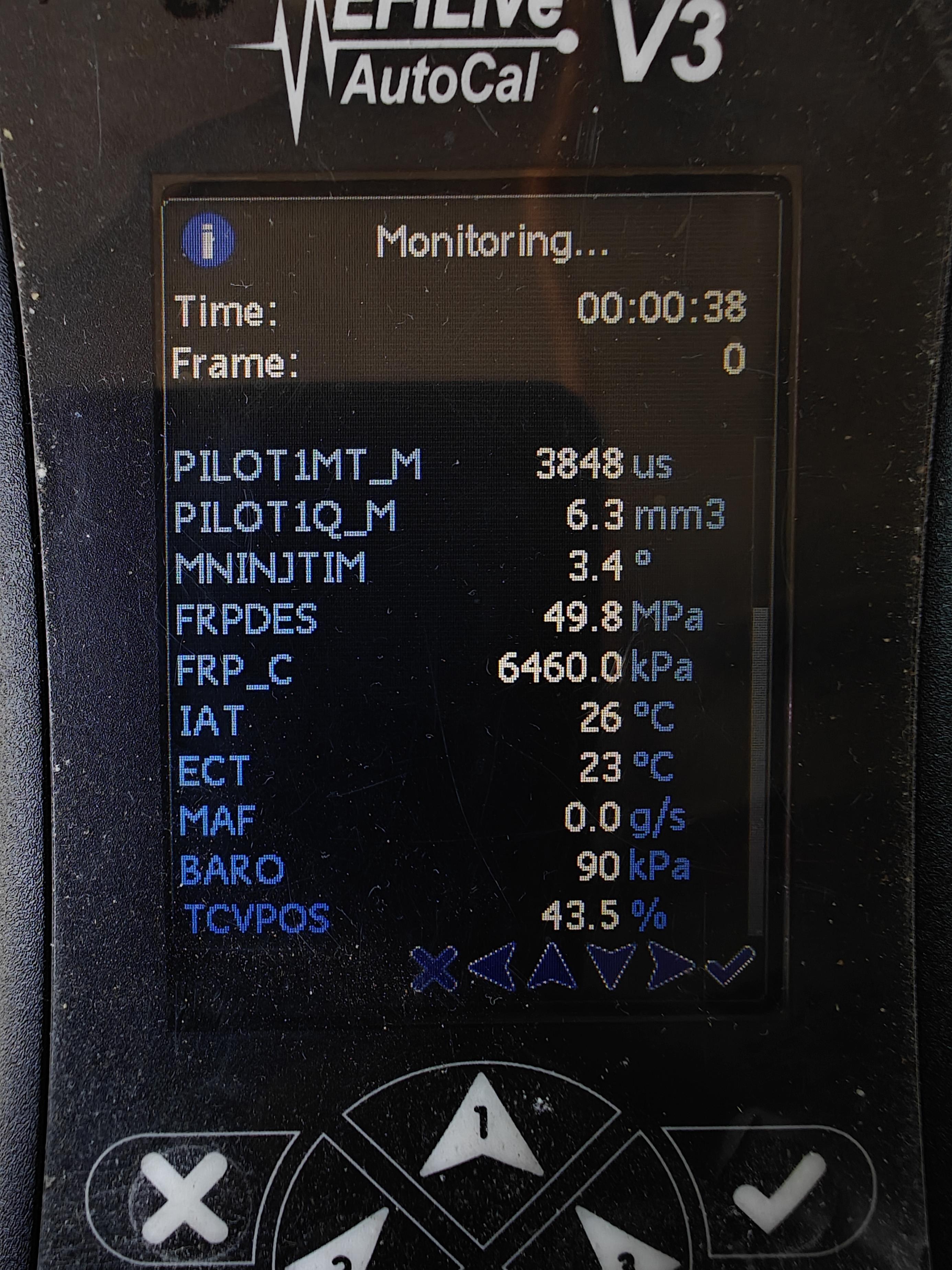

I have the program loaded on the ECM successfully modules are ready.... Brand new CP3 etc. Cranking but no fuel coming through injectors. All components new. Will not start.Attachment 24877Attachment 24877

Yes. Van has a stock lift pump. It's new. Tank pump new. Injection pump new which included Mprop. When bleeding the system it is pressurized very well. I think it's something with the programming or something no trouble codes.
Based on your screenshot it looks like it’s trying to inject fuel. So you bled the fuel filter? Verified you’re getting fuel to the injection pump? Has the engine ever ran successfully while you have owned it?
If you've returned the ECM to bone stock and it still won't start, and there are no security related codes or indicators, it seems unlikely that it's the ECM or tune, but instead something hardware.
