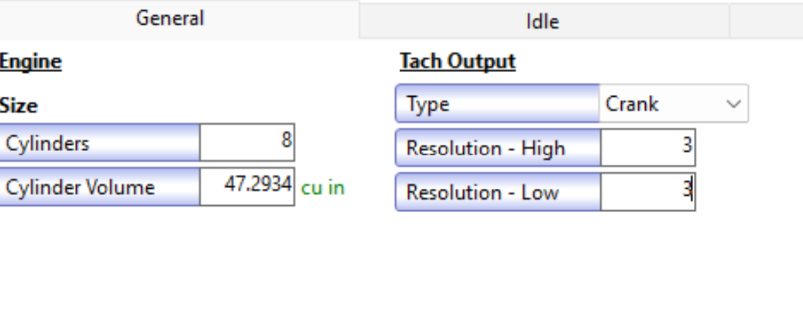

e38 Tach output RPMs too high (LS3 swap)
2013 Camaro LS3/TR6060 swap.
Running tach output from pin 48 with a resistor pickup for the signal. I get signal, but it reads too high. I had high and low resolution set at 6, but it was reading approximately 2x what it should have been. I then read that 6 is for 4 cylinder and 3 is for 8 cylinder so I changed to 3 but now it's approximately 4x what it should be, so maybe I went the wrong direction?
Screenshot attached, any guidance appreciated!
