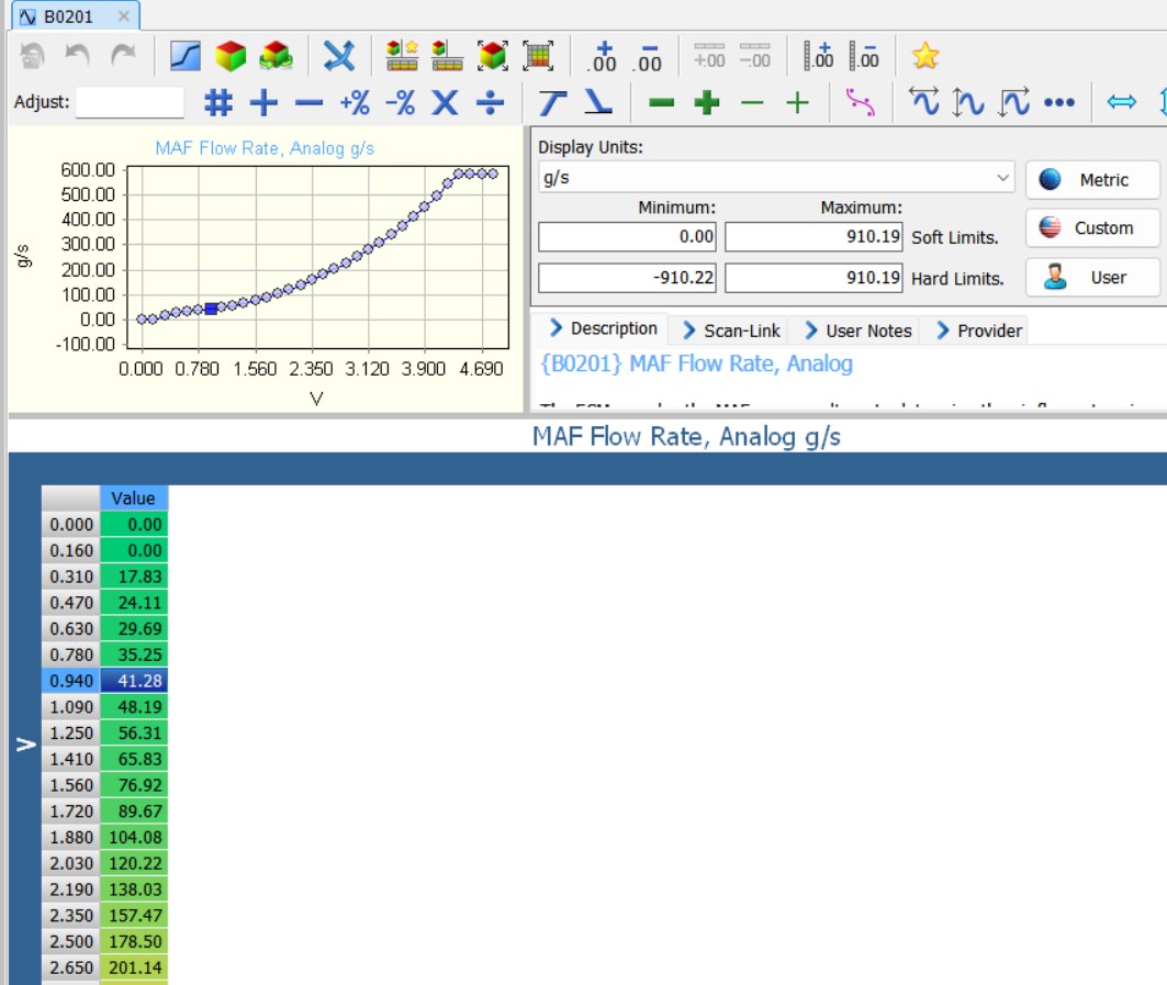

A little confused. You are correct that your MAF is reading too high. But is that with the stock MAF-voltage table? Or one provided in custom tuning?
You would get overfueling during acceleration attempts with a MAF reading that is too high. If using the stock table now, reduce all the MAF values by 25%. Here is the stock table B0201
Attachment 24995
Hey thanks for the reply!
That log is with custom tuning, it is NOT tuned for the larger intake.
Interestingly, the custom tuning (both different files I have) have higher than stock values for the MAF table. I will replace those with the stock values and then drop it by 25%.
Over the weekend I did actually end up bringing it down quite a bit and I got my readings pretty close, averaging at 42 g/s at warm idle. I was running from a rain storm so I quit tuning it.
The intake I am using is a WCFab 4" intake just as a piece of information.
