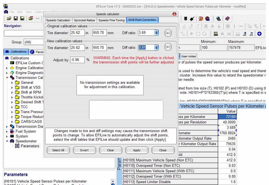

guys,
who knows how to solve the following issue: whenever I change the diff ratio, the shift point correction won't show any table to adjust!!!
Please look at the attachments

The list of shift tables to update is stored in the file:
\Program Files\EFILive\V7.5\cal_adjust.txt
You can add a section that matches the controller you are working on:
[LS1A] = 97/98 LS1
[LS1B] = 99+ LS1
[T42] = T42
[T43] = T43
[ALLA] = 5 speed Allison
[ALLB] = 6 speed Allison
Then put a list of all the tables that you want updated by the shift point adjustment into that section. Then save the file and restart EFILive.
The "=Yes" or "=No" setting signifies whether the table's check box is checked or not in the list.
Paul, I just checked in my V7.5 folder and that file is under \Program Files\EFILive\V7.5\Configurationcal_adjust.txt, might be something to do with the new V8 beta stuff?
Very cool to know about this file, definitely going to be using this feature now!
You're right, my mistake.
It is in \Program Files\EFILive\V7.5\Configuration\cal_adjust.txt
