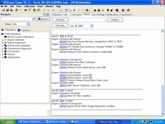

I'm really pleased that the only tables now not stock are ETC and Startup Friction Airflow Correction. Probably due to having a 90MM TB.
