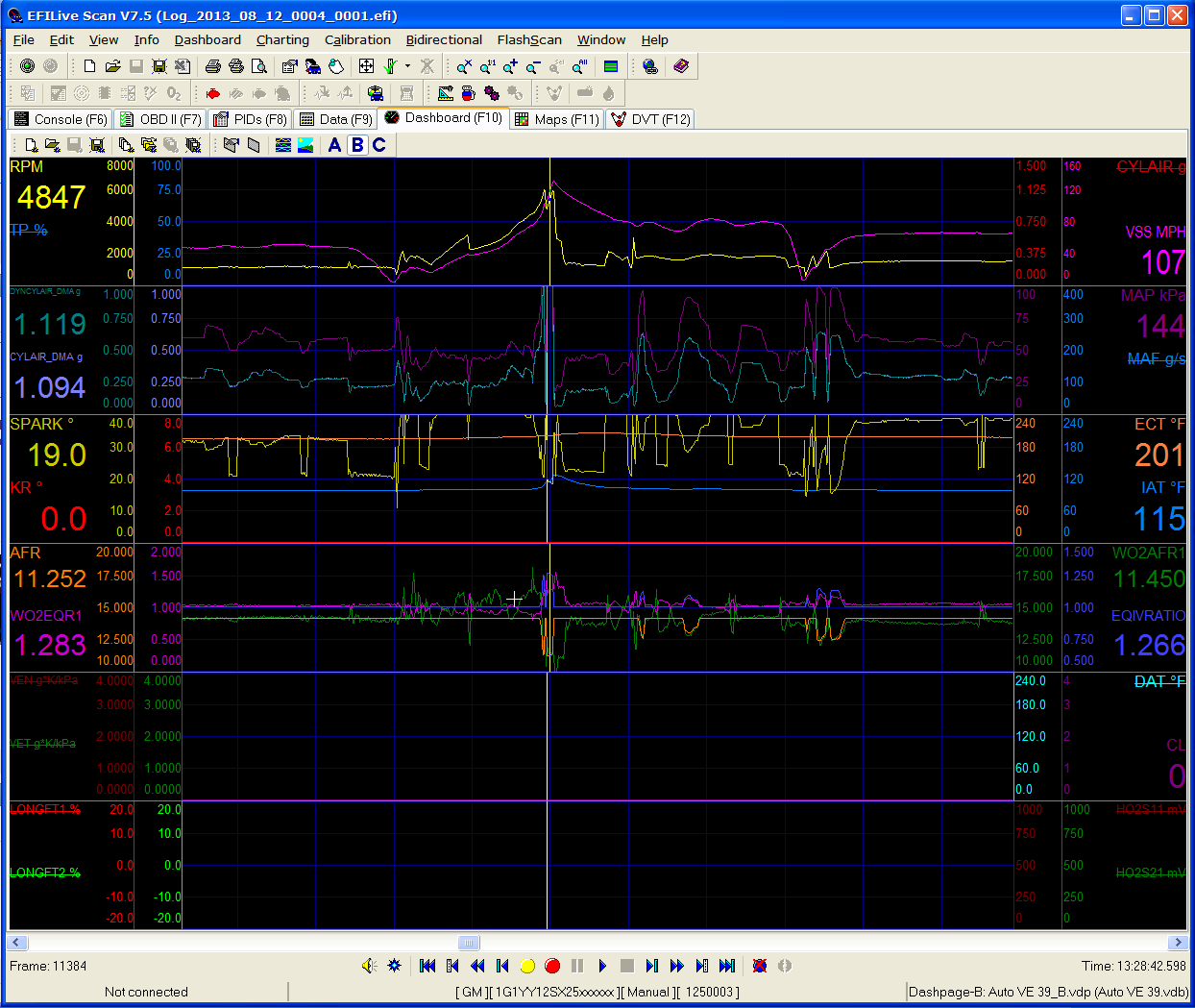

OK, So when I use lambda, does Flashscan V2 automatically assume lambda/1= set (B3601) stoich AFR?
Is the lambda value displayed on my flashscan V2 LCD display, accurate for my set (B3601) stoich value, or the standard pure gasoline stoich value of 14.7:1 AFR?
The LC-1 is a lambda gauge. The AFR reading is calculated based on what stoich is programmed for the gauge. The lambda value displayed is good for any fuel, but to convert to a fuel mass you must define a stoich value, which is where B3601 comes into play.
Calc.VET: correcting MAF and calculating VE (in single log)
Quote:
Originally Posted by
n8dogg
Where I am confused is, after performing several Calc.VET logs and tune adjusts my flashscan still reads that I am running close to 1.0 lambda (14.7) rather than .96-.97 (14.12) which I've commanded into B3601.
1.0 lambda is stoich for your fuel, whether its pure gas or e85. The AFR number displayed by the LC-1 is only accurate for pure gasoline. So if your commanding 14.12 and getting a lambda of 1.0, you are running perfect. Don't look at the AFR output of the LC-1 because its a calculated number from lambda bases on a programmed stoich value
n8dogg
OK, so the lambda output display on my flashscan v2 is a reflection of my commanded stoich afr? Not the WB's factory settings?
Close. It is a reflection of the stoich for your fuel. If your tune is set correctly then yes it is a reflection of your commanded AFR, but if your running e85, lambda of 1.0 will be 9.something AFR even if your commanding 14.67in your tune.
But yes on that the lambda output from the LC-1 is stoich for whatever fuel you are running. It is your job to know the stoich AFR of your fuel and command it appropriately.
n8dogg
If I am reading between the lines correctly, then the LC-1 wideband (when reading lambda) can tell when the car is running stoich, regardless of fuel/ethanol percentage?
Lets say I use the LC-1 in a car that has a good tune for gasoline, it will read 1.0 lambda at stoich (14.7). Then I take the LC-1 out and install it in a car that has a good tune for E85, the sensor will read 1.0 lambda at stoich (9.0)?
Yes.
