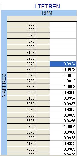

Ok, guys, Here is the LTFTBEN table. After messing with trimming the image down in Paint, and saving it as a jpg, I finally got it to upload.

RevGTO,
On the scantool map, does the second column say "Value" at the top (in post #126)...?
If it doesn't then paste-with-labels won't work.
[ it probably says "RPM"... in the map properties, on the Col tab, change the Title to "Value". ]
http://forum.efilive.com/attachment....5&d=1269203449
This map does not have matching labels, this is why you can't paste w/labels.
