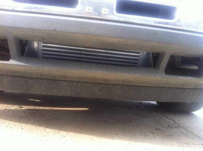

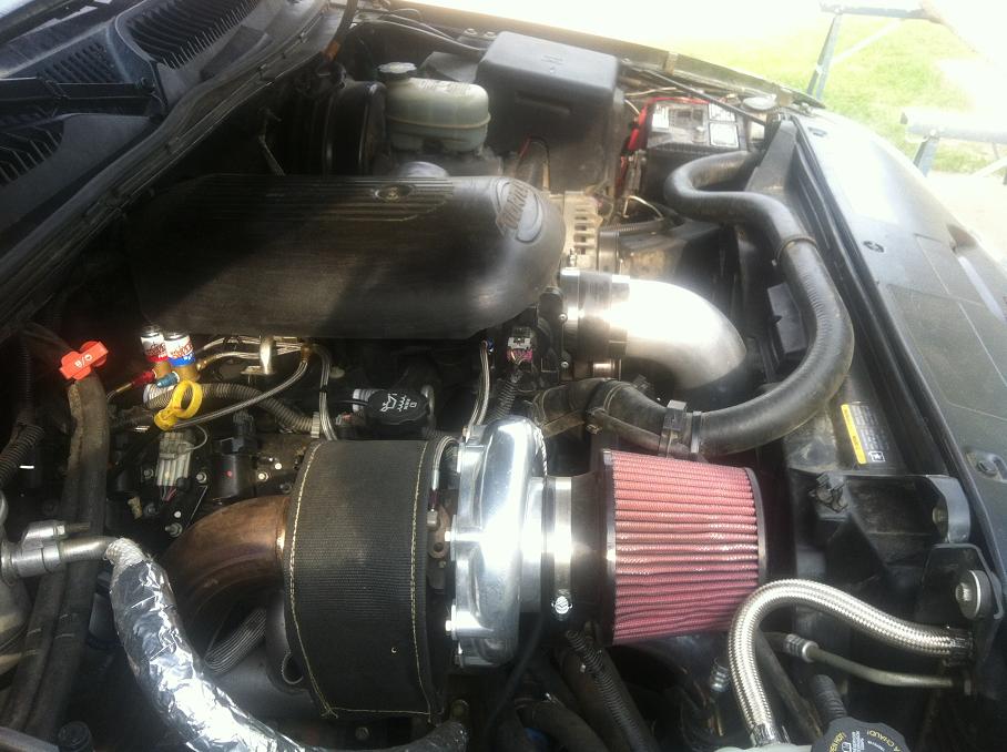

Here are the pics. Nothing fancy just a street truck...
Going to load in the tune and log it before it rains again. If you want pics of the engine build ill post those as well.

Definitely a sleeper! Love it! Noone would suspect a 427 turbo in there... :angel_innocent:

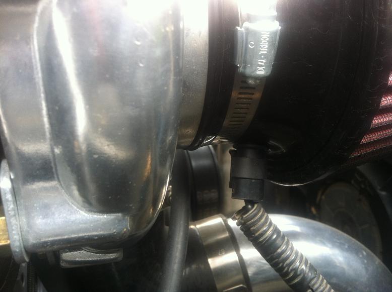

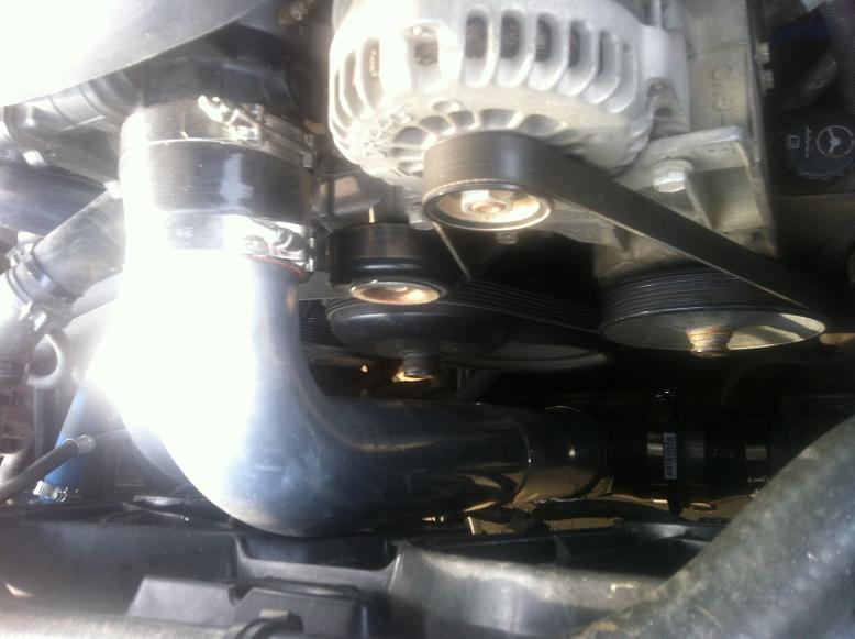

That IAT sensor definitely needed moved after seeing the pics! That elbow before the throttle body would be a great place to put a meth nozzle... :sneaky:
Is there a MAF sensor in there? Thought I could see it in the one pic... you don't need that anymore...
Yeah I'm asleep when you write in the morning. Haha. I was going for the sleeper look. A few subtle things like a 4 inch drop, head and tail lights and an exhaust system. I Usto have a nice set of rims for it but sold them and put my perf tires on the stock rim to be sneaky. I put the iat sensor in that rubber elbow. :) I have an old tb spacer in the truck that is tapped and ready for a wet inj systems. Have my nitrous nozzles, boost lines and maybe one day water meth kit to put in. And the nice thing is its all under the vortec beauty cover and hard to see. Tha Maf sensor is still
In Iv yet to remove it. I need another piece of pipe before I do that. But it is all disconnected. The thing I love most about the truck is its 4x4 and man does it launch. I raced an srt10 and won by a fender I
