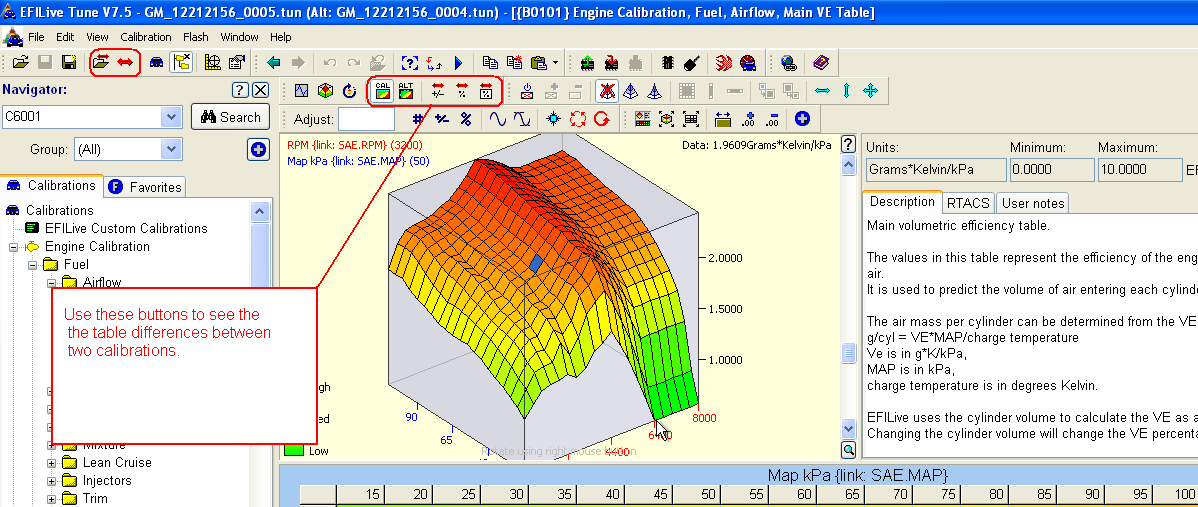

Yes, try that tune...
in the tunetool, go:
Edit->Properties->Options
and click on Calibraion - Alternate (i.e. the one on the right),
click OK.
To see the differences, open the tune file, then go like this:
File->Load Alternate Calibration For Comparision
and browse to the old file;
Then do:
File->Display Calibration Difference Summary...
You can now click on any difference and it takes you to that table.
(Or see the 2 buttons circled in red in the image below)
While viewing the table, these 5 buttons circled in red let you see the new table, the old table,
the +/- difference, the % difference, and the absolute % difference:
http://forum.efilive.com/attachment....5&d=1224710204
