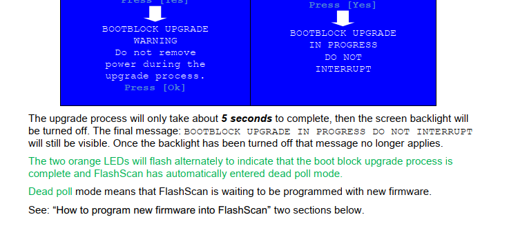

the buttons on the v2 don't do anything and the screen is dark, can I still do that?
That sounds like you have just performed the internal boot block update that updates you from V2.04.xxx to V2.05.xxx.
The dark (un-backlit) display probably shows something like "Boot block update in progress do not interrupt".
That stage is explained on page 5 of the upgrade document (sorry no page numbers, you'll just have to count the pages).
Attachment 23248
The boot block update process only takes about 5 seconds, the LCD back light is switched off to indicate that the boot block update process is complete.
You can power cycle the V2 device to bring it back to normal functionality.
Please follow the rest of the instructions in that document to continue updating the firmware (and boot block) until they get to V2.07.xxx

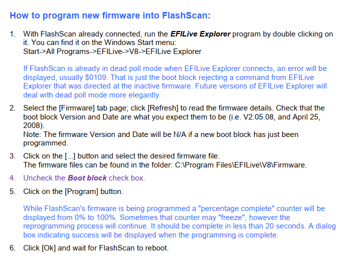

From there, follow the instructions in the upgrade document, starting at this page:
Attachment 23249
Th page prior to that explains how to update the boot block.
Right now your device has boot block V2.05.xxx
Essentially what you need to do is
1. Use EFILive Explorer to get program matching firmware V2.05.xxx firmware into the device, that will allow the device to run normally so you can update the boot block from v2.05.xxx to V2.07.xxx.
2. While it is running normally, use EFILive Explorer to program in the latest boot block (V2.07.xxx).
3. After programming the latest boot block it will go back into dead-poll mode (it always goes back into dead poll after programming a new boot block).
4. Use EFILive Explorer to get program matching firmware V2.07.xxx firmware into the device.
