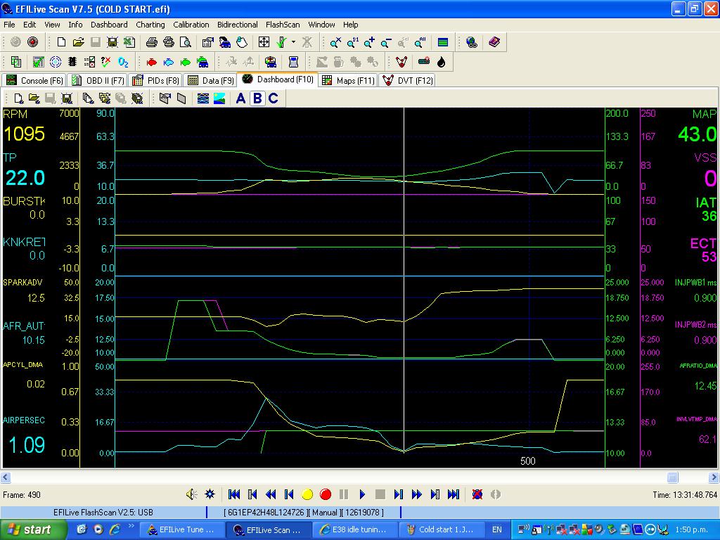

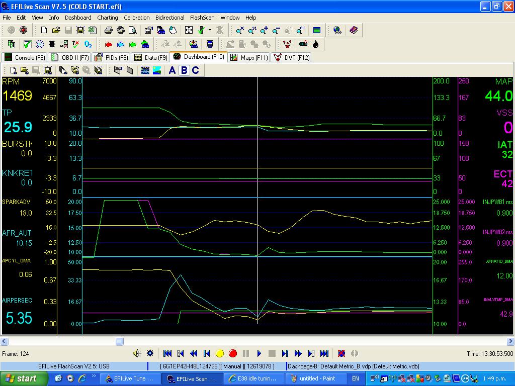

I still prefer the original method of maxxing out max idle air. I can arrive at the point a lot faster. The integral correction is still taking place otherwise I try to eliminate that. The amazing thing is if you "lock out" the air you can then push the timing up and down(with no correction) while datalogging and engine running, I keep the air fuel in the high 13s and then raise the spark up and down until I get the best idle vacuum. In most cases then I run very minor correction in both timing and throttle like -3 deg max for timing and 0.080 for integral as a max number. Thats how I get them with a standard idle. Usually at the drags/etc combined with varex mufflers it passes as a 100% stock engine at idle. Fuel economy drastically improves around town and it really passes as a stock car to drive, Most people even if they love a tough sounding engine always go this way as it is so much better to drive. Most tuners just try to get the car driving and eliminate hunting and stop there. Go beyond that. Lock airflow, adjust timing with DVT. get in open loop Note down the max idle air, and adjust timing, increase air try different timing again. Once you arrive there establish min idle air and get the corrections to a minimum with a bypass in the TB. Cold start and drivability it all goes hand in hand.
