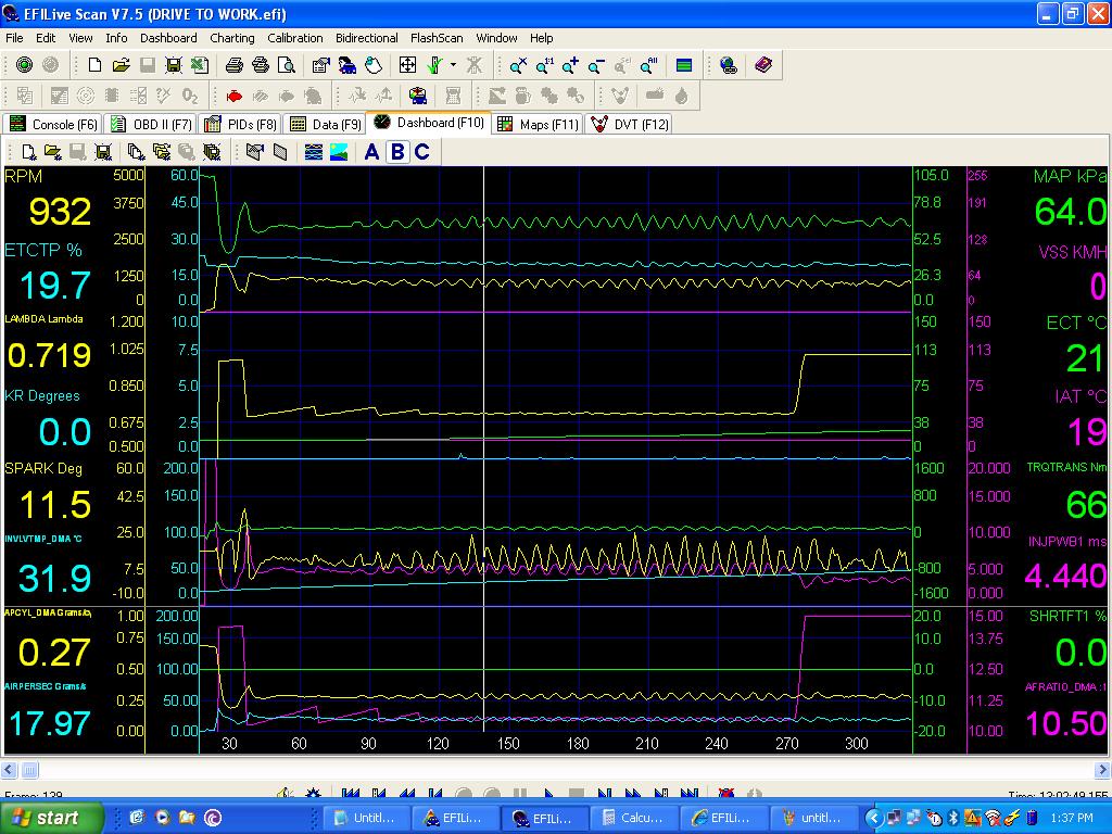

Attachment 12807Attachment 12808
THIS IS THE COLD START , AND A DRIVE TO WORK, with b0146 set all to "1" as well as the b0147 b0148.
as you can see something is commanding 10.5:1 or 0.716 lambda for 40 sec after starting. Screen shot zoomed in on AFR and lambda. You can also see that for 15 sec after startup 3 small blips on the commanded AFR/Lambda.
ANy ideas about this?
Perhaps Ross may shed some light here for us > Ross?
cheers,
Mike
