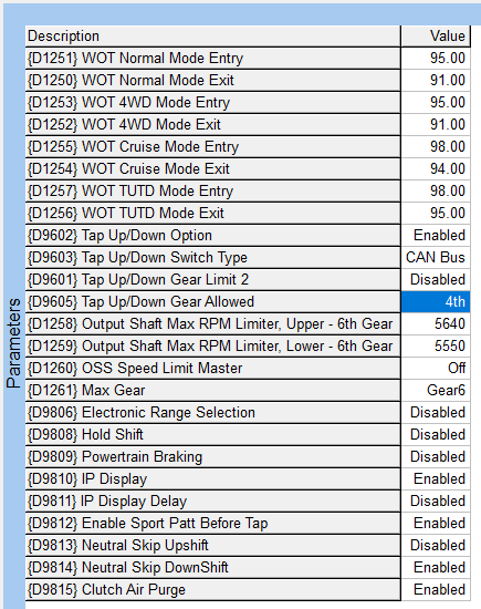

any idea if D7010 and D7011 could have anything to do with it? Ive tried them almost every which way, but no real changes to the TUTD behavior.

Basically there is a factory parameter called Electronic Range selection. It's enabled in your tune.
Basically that being turned on is preventing TUTD from working.

When you refer to electronic range selecting, are you speaking of the D9601? I have had that as enabled and disabled and it doesnt seem to make any discernible difference in tapshift behavior. D9602 is the one that perplexes me. If it have that set as enabled, when i shift past D into M mode, it just sits in D5, and the tapshift buttons do nothing. If I have D9602 set as disabled, and i shift into M, gear 1 shows up on the display and i can tapshift, however it just acts as the max-gear selector. Does not allow me to hold a gear regardless of throttle position.

If M is D5, then you may need to change D9605 to 5 also.

My shifter is PRNDM, and I did try D9605 as 5, no dice still. Do you have a link to any information about this "cax" stuff. I can probably figure it out if its not proprietary.
