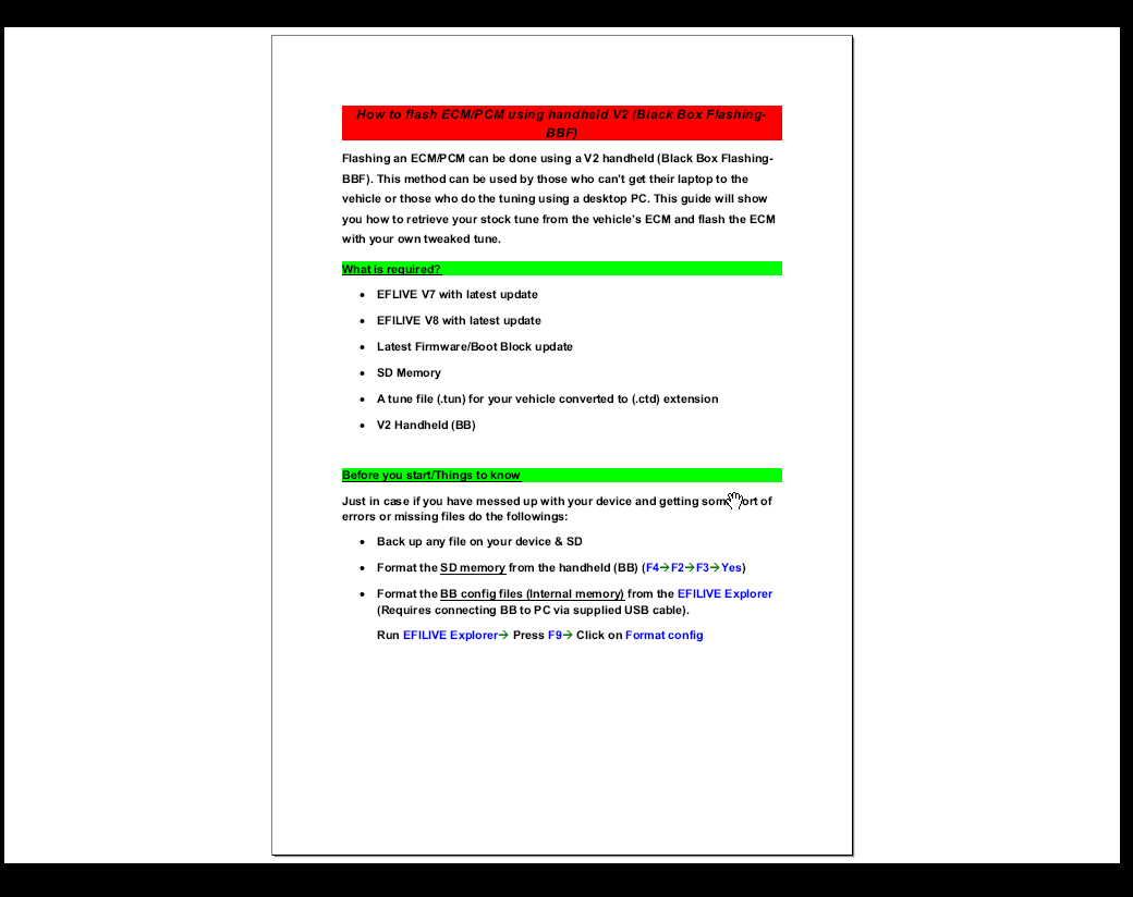

You don't see anything like this (see pic)...?
I get that after I hit the 'Esc' key. When it first opens it looks like this. There is no Header/Toolbar.
Attachment 8671
I'm not sure why it does that... let me find out.
When I open it on my PC's, it pops up a box that says something like "Full Screen Mode?" with Yes and No buttons...
I can't find anything that describes the screen going black.
I redid the pdf using a different program, see attached, try this and let me know.
Seems to work good on my end..:)

The PDF instructions are readable no problems.
