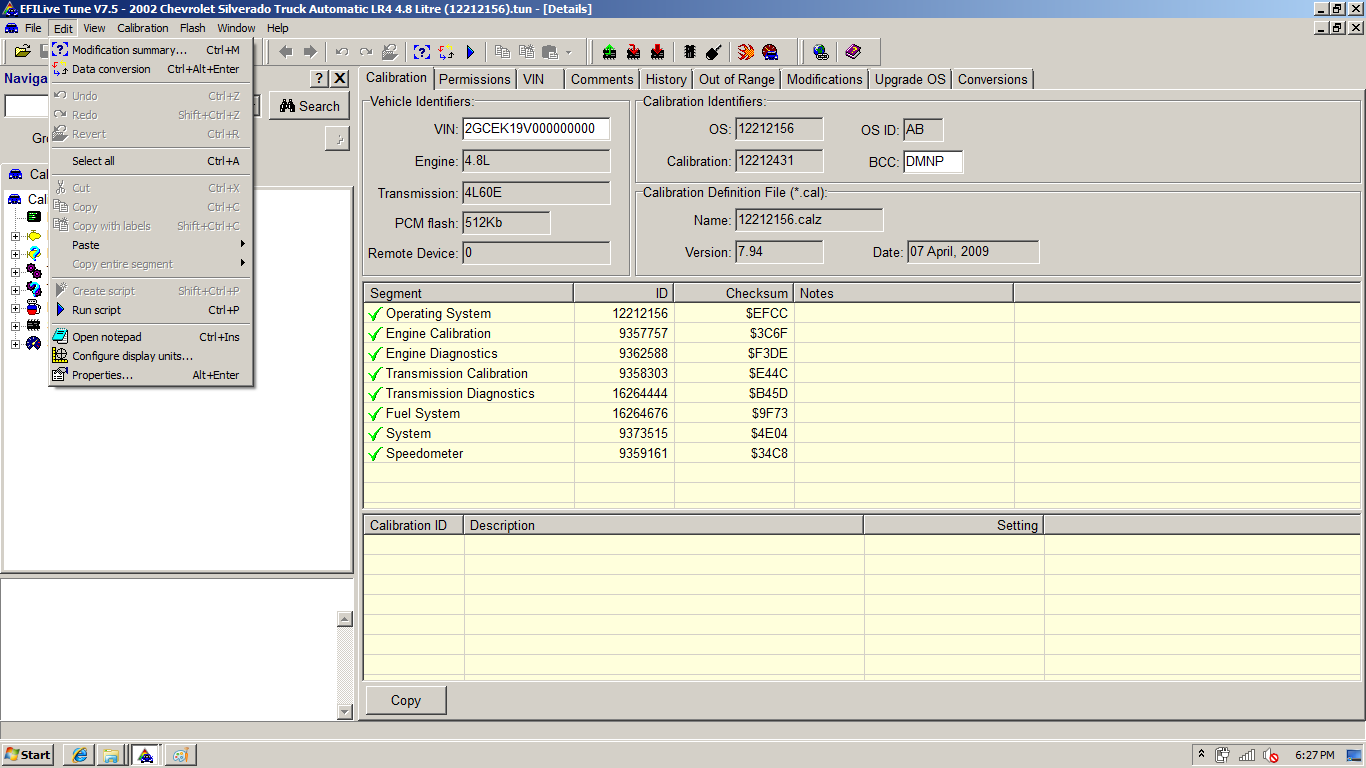

Here's a pic of my screen showing what I'm trying to do with the segment copy. As you can see, the Copy Entire Segment is greyed out.
Attachment 10468

It looks like you only have the calibration file... you also need to have the alternate calibration file.
1 Attachment(s)
Yep load the alternate tune with the 4L80E trans segment using File->Load Alternate calibration for comparison. Then click Edit->Copy Entire Segment, do both the Transmission and Transmission Diagnostics segments. Save the file and there you go. It works, just did this one a minute or 2 ago.
It is the same file I posted a link to earlier, except it has the 4L80E trans and trans diagnostics segments from an 02 Express Van loaded. Should be able to flash it and go, use the LC .cax to enable Lean Cruise then adjust it using the LC tables available.
