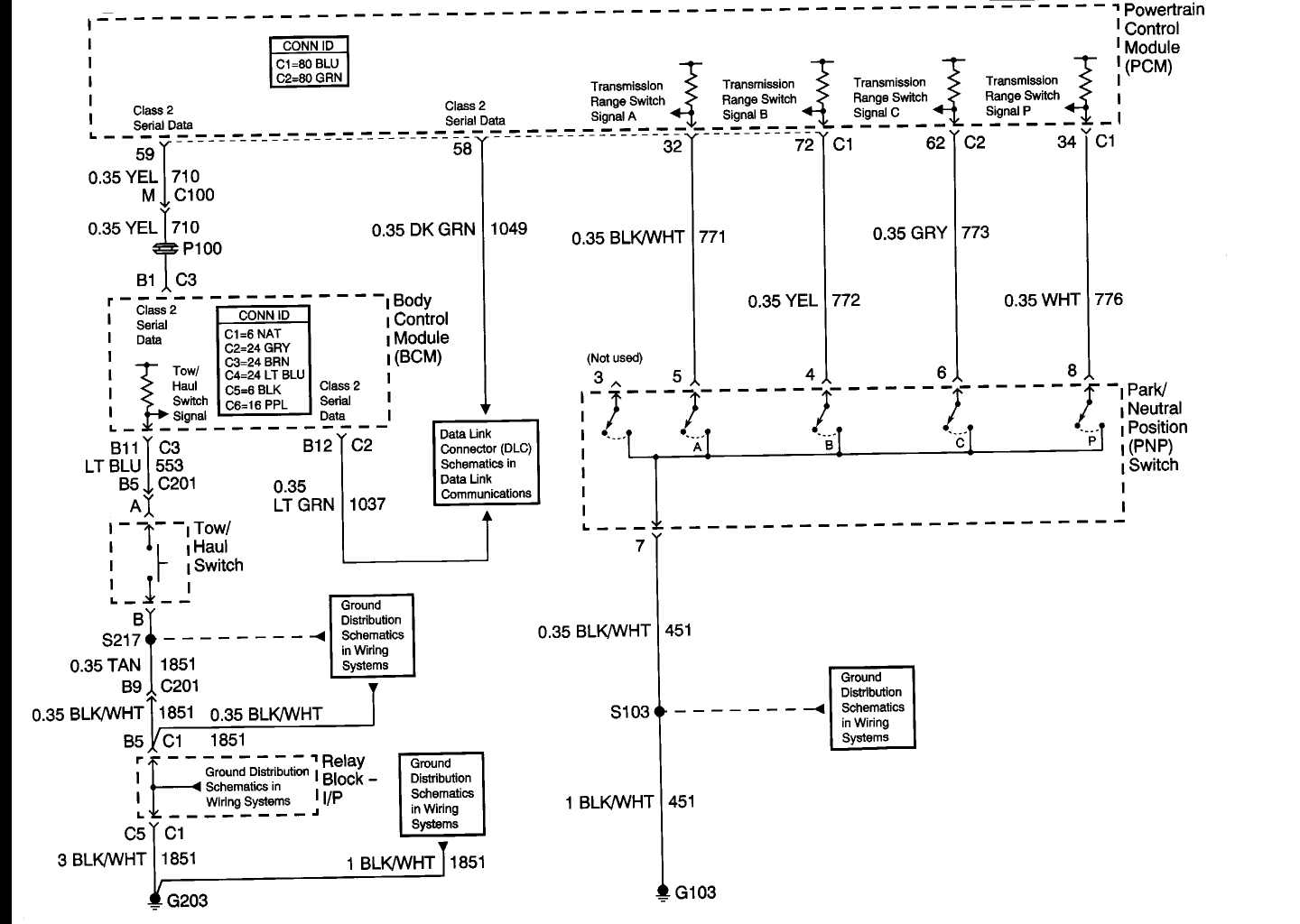

I've got a Lq9 with a 4l60e behind it, running with a stock harness modified to stand alone. Now I need to run a crank learn and it wont read park position. I wired in a P/N switch, and tried grounding 32 and 32. still no park.... Any Ideas? Also drive by wire should hit rev limiter at 4k in park Correct?

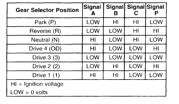

I am going to go out on a limb and assume that you are dealing with a '04-'05-ish LQ9? I have attached the logic/truth chart for the park neutral switch and the wiring diagram for the park neutral switch. My advice to you would to be wire in the correct park neutral switch (there were 2 designs, early and late, I think you can interchange them, just have to wire the appropiate pigtail to it!!) to your 4L60E and then reattempt to do the crank learn procedure. Any time I had issues with crank relearn, it usually always boiled down to the PCM not thinking it was in park. Hope this helps!!

You are using a PCM calibration from a vehicle with a PRNDL switch on the side of the transmission.
You have wired in a P/N switch (which will supply a ground to the PCM when in park/neutral, otherwise open).
Now you need to change the gear select type to P/N Only. This is not available in EFILive. It can be done with TunerCat OBDII or HP Tuners.
However, without the gear select type change, you should be able to ground BLUE 32 and BLUE 34 to accomplish the park signal for the sake of crank learn. The problem with faking out the PRNDL switch (as just mentioned) is that for some reason the transition time to indicate park and in-gear is several seconds. I could see this as a potential for idle issues when transitioning from park to in-gear.
If crank learn still doesn't work...make sure no other DTCs are set. I've experienced crank learn frustrations because a fan DTC was set (the fan signal wire was not connected to a relay).
Sorry I didnt put the year in there, mine is an 02. And I also put a P/N when I meant I have a PRNDL switch. Sorry for the confusion. And I have tried just grounding 32 and 34 and still no park. Im starting to wonder if the problem is in the tune. Does that logic table still apply to the 02? Im thinking of going to a dealer and seeing if a Tech2 can command park and run the Crank learn. And as far as DTC's the crank learn code is the only one there. Sorry for all the questions, I just gotta figure this out! Thank y'all so much for the help!
If you post a copy of your cal I should be able to change the PRNDL to just a P/N switch with tunercat. I forgot about that!!!
The logic table also applies for the '02, as all truck based calibrations used the PRNDL switch and the F body cals used the P/N switch!!
If all else fails, you can fake out the PRNDL switch signals with a few jumper wires and some battery voltage to the correct pins on the PCM!! ALthough, it is much safer to fix it the correct way.
Get me a copy of the cal and I will see what I can do
Mike
