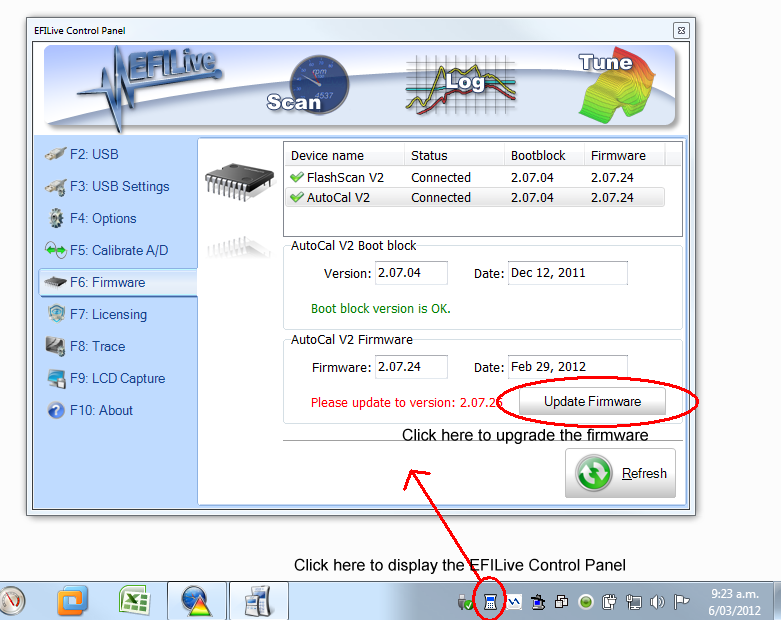

There are two ways to update the firmware in Autocal and FlashScan:
1. If the firmware version in the V8 software that is installed is higher than the version in your device, the first time you run the EFILive V8 software with your device connected the software will pop-up a window asking you to upgrade the firmware. You just click on the [Upgrade] button and it all gets done automatically.
Attachment 12745

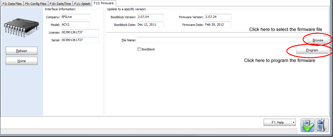

2. If you have auto firmware update notification turned off, or you want to change to firmware that has the same version as what is already on your device then you must manually program the firmware into your device. To do that, run the V8 EFILive Explorer program and on the [Firmware] tab page, select the firmware file that you want to program and click [Program].
Attachment 12746
