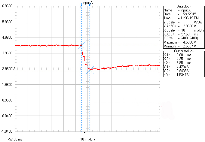

Here is a trace on the analog output. Going from free-air to 14.7AFR
Attachment 20750
You can see the steps 2ms apart. Even the CAN data only updates every 10ms. Which is one of those dividing lines.
