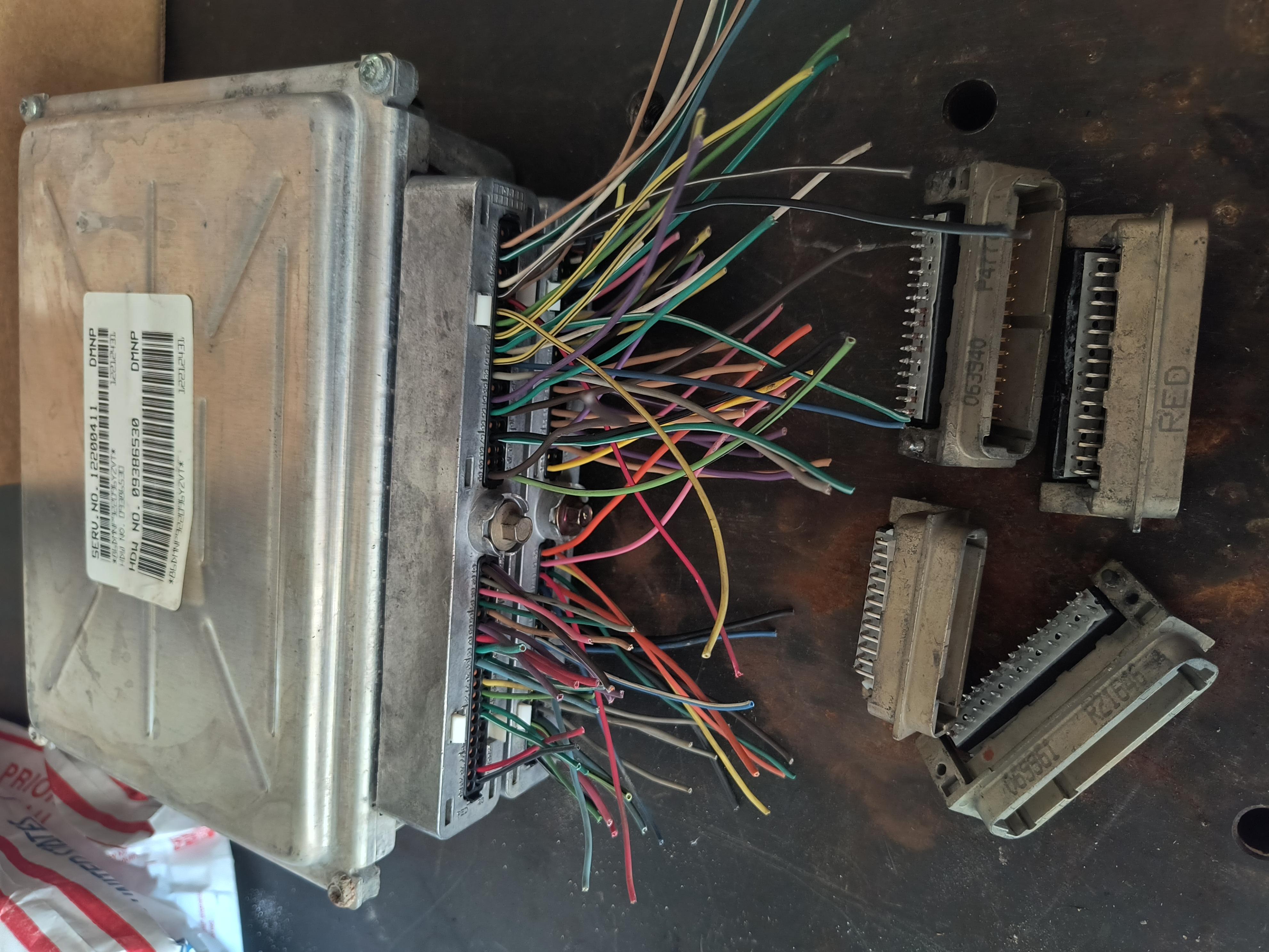

I have an L31 apart, I'm about to remove the sockets and actually build the L31 to 0411 interface cable.

I guess I'll have to get up on the segment swap thing figured out, to get the 4x4 stuff in there.
All I can think of is the torque limit for low transfer stuff. I definitely want to keep that in there. I pulled a diff into pieces one cold winter day pulling a tree up to cut for firewood...
The way I got 4lo to work properly was to start with a 12212156 based tune so I could steal the system segment out of a GMT800 truck. That was all it took to make the 4lo shift properly. None of the CAX files were of any help to me there.
I did get my 0411 swap done a couple weeks ago thanks to a couple of very helpful guys here
Thanks nonieselman and chipsbyal.!
@ supercharged111, 4lo works but I can't tell if it's hitting all the gears without a load.
Great forum guys !!
Before I swapped the system segment I could get the truck to shift if I laid into it. Much more effortless after the segment swap. But before that I was able to cheat by plugging the output speed sensor from the t-case into the back of the trans but that made my speedo incorrect in 4lo. Only reason I could do that is because that donor started life as a 2wd unit.
