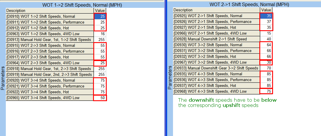

Hi JM,
the problem is this:
your WOT downshift speeds are above the WOT upshift speeds... they should be below (at least 5 mph lower)...
set D0925-7 below D0910-2,
set D0930-2 below D0915-7,
set D0935-7 below D0920-2.
Attachment 13762
Same applies to the part throttle downshift/upshift tables (the downshift should be below the upshift at each corresponding throttle position) .
BTW those WOT upshift speeds are quite low...

Joe you know I'm in no way trying to step on your toes as you are the master with this stuff but those shift tables he posted are stock. And every truck based 4L80E tune I've ever seen have the downshift speeds higher than the upshift speeds so I wouldn't say that is the issue. Suppose it makes sense too. It can't downshift unless it already upshifted first, correct?:redface:
