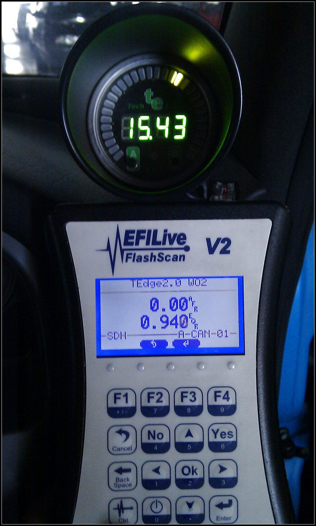

I get EQ and Lambda data, just no AFR. I did the display test before posting to confirm something was there ( V2 configured to display AFR and EQ Ratio ). The AFR data remained at "0" while the EQ changed value. If I pull apart a log file, I see the following.....

here you go.....
Attachment 12640
And an image of the TE display with the V2 display....
Attachment 12639
Simon.

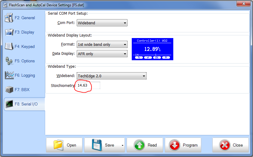

Ahh, now I see the screen shot I can see what the problem is.
One of the updates that went through recently was to allow you to specify the stoichiometry for the fuel that is in use.
Yours is probably set at zero which means the conversion from lambda (or EQR) to AFR is failing.
Go into settings on the V2 device and set stoich to the value you need/want it at.
Or change it in the Device settings of the V8 software.
It is supposed to default to 14.7 if the user does not set it - I'll need to figure out why its not doing that.

Ahh, that sounds like what's happening. I was really confused that I was getting EQ and Lambda but not AFR. I'll give it a test and report back, thanks again.
Simon
That was it! I must have cleared it by accident when reapplying all the settings.
Simon.
No it wasn't something you did. The config value will always be zero until you explicitly go in and set it for the first time.
The firmware was meant to cater for that by checking for zero and defaulting to 14.7
The default was not being handled correctly for some WO2 controllers.
Basically each controller type has a separate function that computes the lambda value from the raw serial data and also converts it to AFR.
The code was reading the config value and initializing it to 14.7 if it was zero.
However in some of the routines the stoich value was being re-read from the original config value (and getting set back to zero) instead of using the default that had already been set to 14.7.
