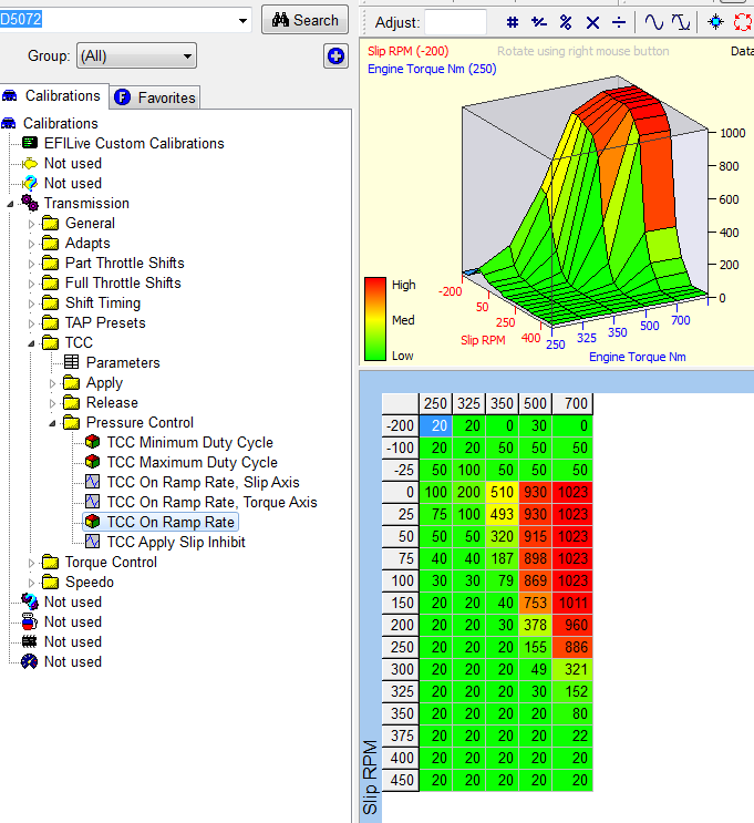

This would be a huge huge huge help also. What weird is that my 05os has the table as 3*17 and another 05os (sequence 000000 downloaded from holden crazy) has the same table D5072 at a 17*3. Im also assuming the cell values should have units of psi/second as the cells are defined as ramp rate. So a greater engine torque requires less time slipping to increase clutch life?

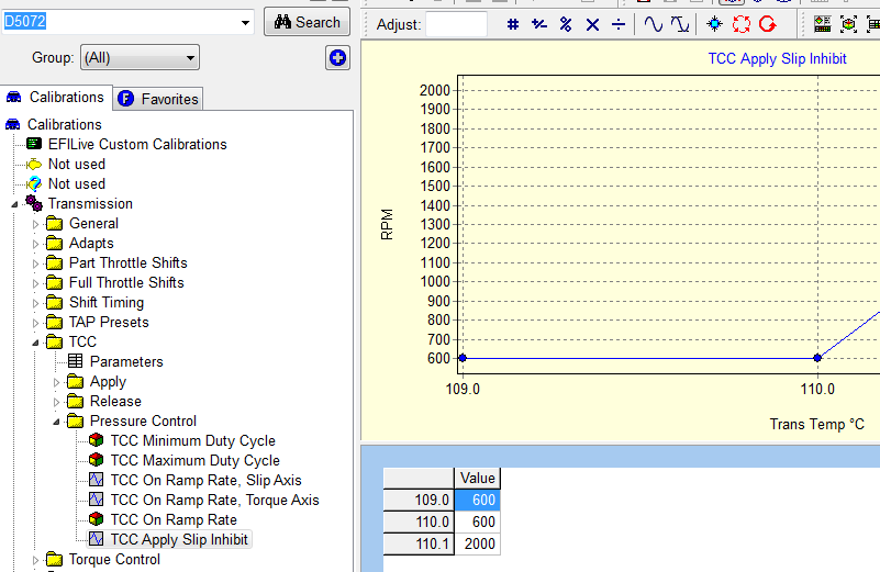

The A40 as an example, we didn't define the table correctly, we said there was only 3 columns, not 5 like there is, that means you are not seeing the rest of the table. The changes we made are the same as what the original poster made, we've fixed the table so the entire thing is shown (5 x 17), we also have the axis points so you can change those too (see the attached pic).

Ok, well that single parameter became a small 3 value table in the A40 (at lest the OS's I checked).
If we include both the 'fixed' 5 x 17 table and the slip table are we on the right track?
