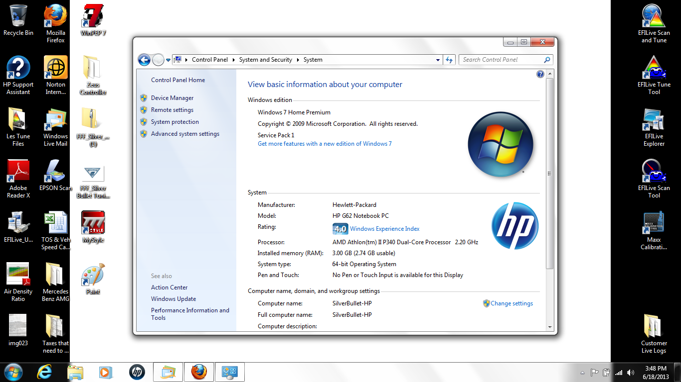

Paul,
I respnded to your PM, but I will post a screenshot of my setup.
