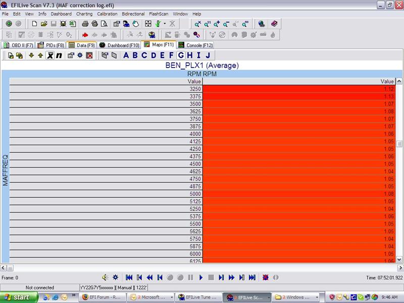

OK, does this look right?
http://www.retrorelics.net/jim/Board...MAFFreqben.jpg
So I would do something like this to modify the MAF FREQ table when I have enough samples...This is halfing the Ben Difference per SSpdDmon
http://www.retrorelics.net/jim/Board...xcelMAFben.jpg
I would apply the new values and relog til I was satisfied...

Make sure you have enough resolution on your log. 7.2 and 7.24389 are two totally different numbers when it comes to the MAF. Other than that, it looks like you're on the right track. :)
No matter the precision you see the software always copies out to 6 or so decimal places. This can be verified by copying and pastign in Excel
