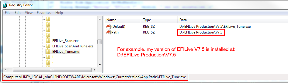

The registry setting that the latest installer uses to figure out if an old version of the software exists is:
\\HKEY_LOCAL_MACHINE\SOFTWARE\Microsoft\Windows\Cu rrentVersion\App Paths\EFILive_Tune.exe
Attachment 14202
It then looks at the version number of the exe that the registry key points to, which will usually be either:
\Program Files\EFILive\V7.5\EFILive_Tune.exe (on Windows 32 bit systems)
or
\Program Files (x86)\EFILive\V7.5\EFILive_Tune.exe (on Windows 64 bit systems)
It then looks inside the *.exe file(s) and to determine their version numbers. And based on the version number it finds it may complain that an old version exists and should be uninstalled first.
It will only do that once, because after you've installed the latest version all future updates can be installed over the top of the existing install without uninstalling first.
Either way, if you delete the folder(s) referenced by the three registry keys, then the new installer should not complain that an old version of the software exists.

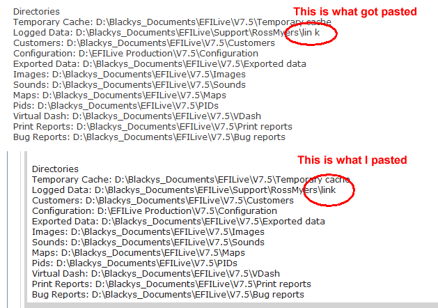

Actually, look at the spelling of " \Document s\ " vs "\Documents \"
( see the position of the space before vs after the "s" )
Quote:
Originally Posted by Rick Martin
I think those spaces are just an artifact of copy/paste between EFILive's error report screen and the forum. I'm not sure why it happens.
See image below for an example.
Attachment 15618
ah, ok... ( I thought I was onto something :) )
