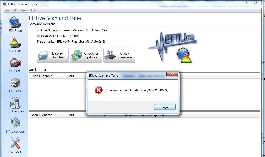

Hi,
I have this Issues in the V8 software on a windows 7
Attachment 13337
the v7 software is ok with me but the v8 is not.
can someone help me with that?
The regional settings being set to a non English local is the only known way of getting that error to occur. Similarly, setting regional settings to English (United State) has worked in all other cases. Please do double check that you correctly made the recommended adjustment.
