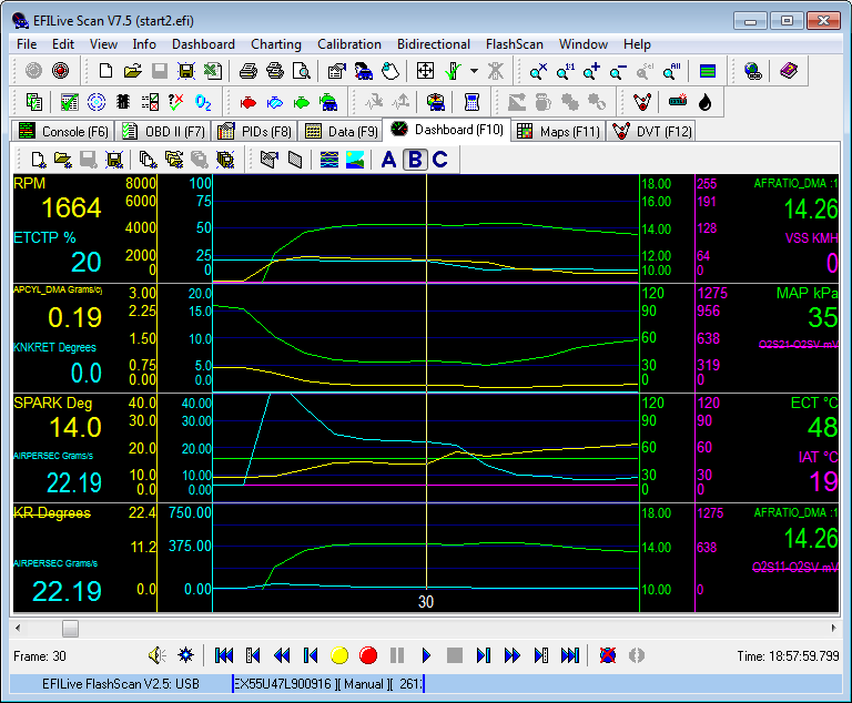

Set the whole table to 14g/s. Yes the whole min idle air table. Start the engine and while logging etctp watch what it says. Please note this is the main value you check while adjusting max idle area and min idle air.
Once the engine is running take note of the TP%. Rev the engine let it settle to idle and see how long it takes for the TP to start trimming. If min idle air is to high it will take 10-15 seconds before TP reduces from the max idle area position and starts to trim. If its to low and min idle air needs to increase. It will trim immediately if it is low. We increase until it begins to max out then we keep those values. Again, when there is a delay in trimming by 10 or more seconds we know it is maxxed out. Experiment with 14 s a starter and likely you will need to reduce some calibrations are different, Generally 8g/s is where it ends up.
