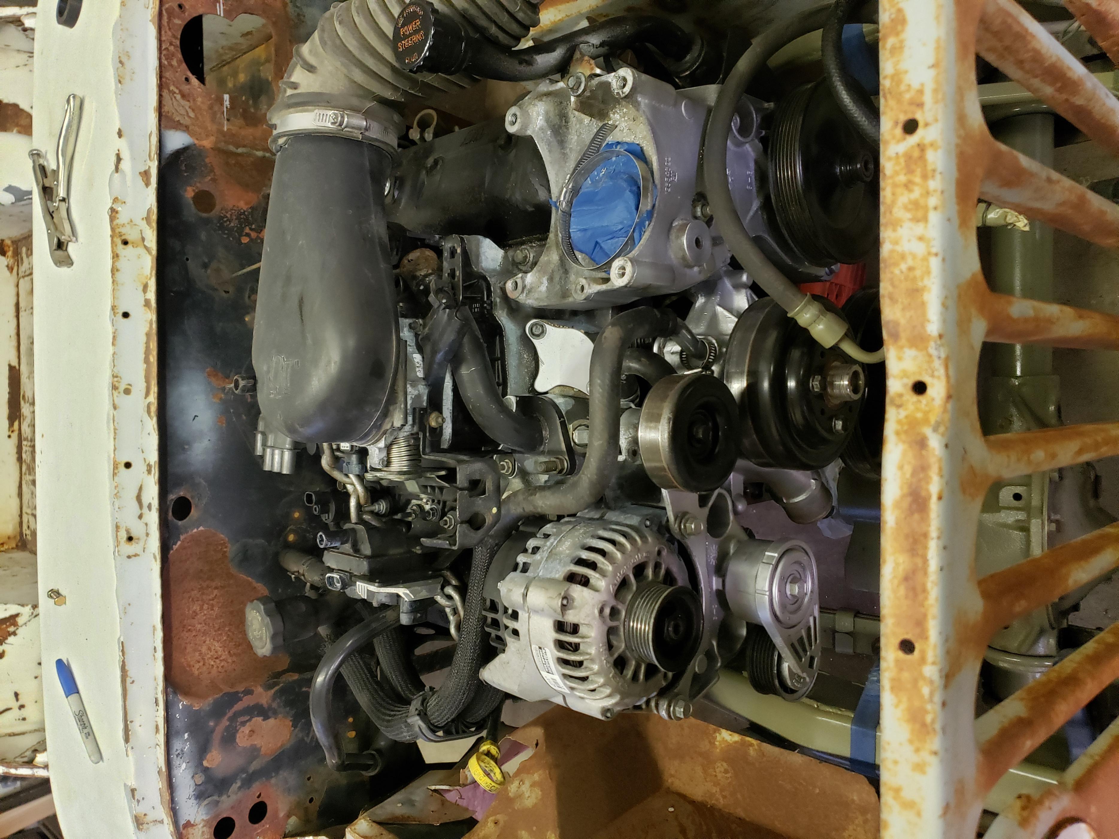

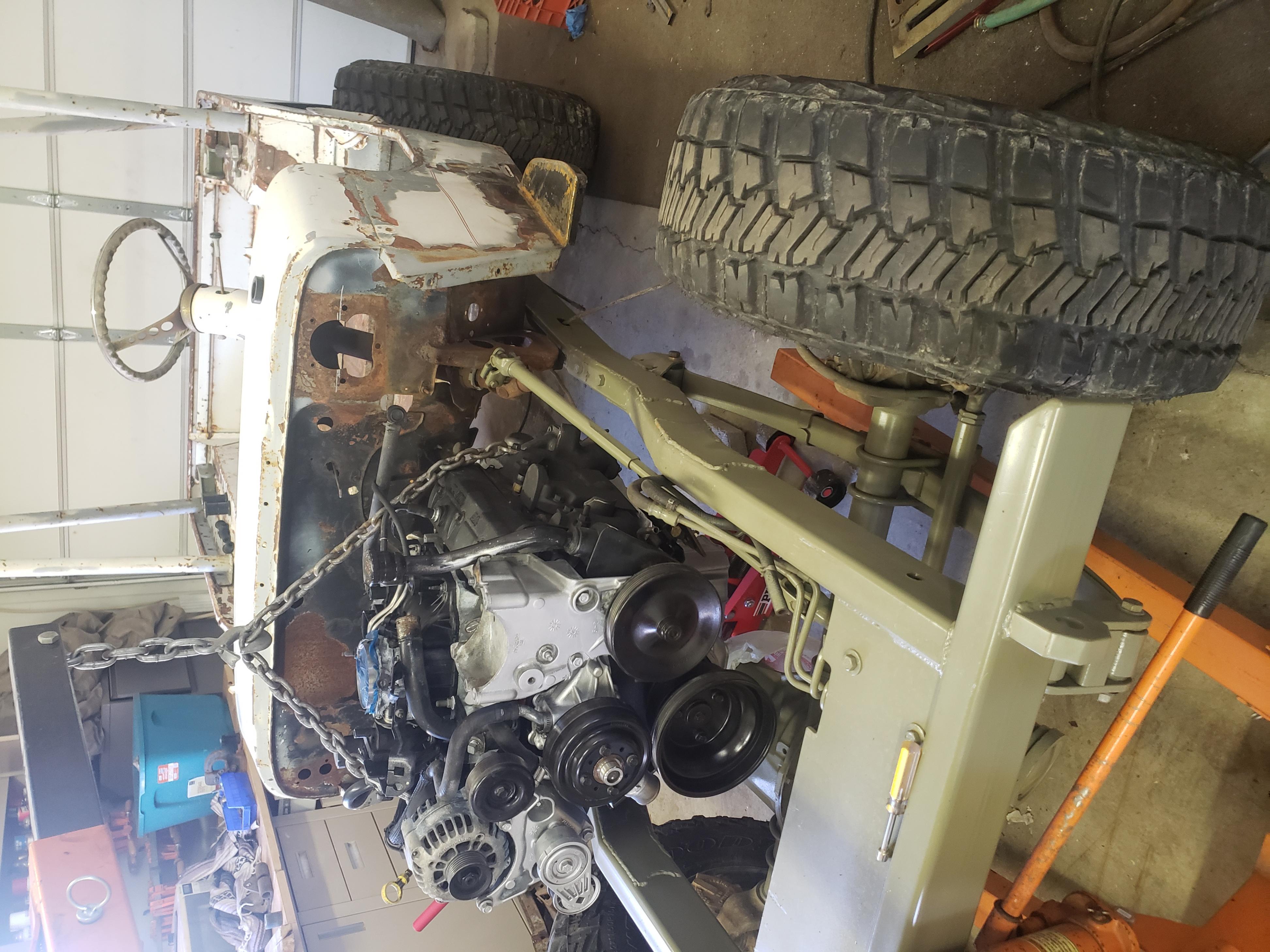

I am transplanting a '99 4.3 in to a 4x4 build of a '52 Willy's CJ3A. I want to swap the black box from the Blazer to a 0411 PCM. I have already emailed Lextech asking for pinouts for this application. I would like to know if there is an advantage to pinning the new PCM and tuning as an Express Van, as some have done, or if I am best to pin and tune as a 2002 Blazer. I am not sure if the pinning is the same or not. I have attempted to compare pins of the different years but find some discrepancies that make me unsure. I will also be making it a stand alone system without EGR, rear O2 and other emissions. This project has been an exciting challenge for me and even more exciting as I get closer to installing the drive train. I hope to drop her in this weekend for the first fit.

I will be working on my wire harness this weekend. Most of my time this past week was positioning the engine, fabricating frame horns for the motor mounts, and trying to figure out how everything is going to fit in that tiny engine compartment. The steering is going to be a trick. I just purchased a steering column and parts from Speedway Motors. The exhaust manifold has an EGR port that protrudes out right where my steering shaft needs to be. If I can't get around it I will need to find a manifold that doesn't use EGR. I have compared the '99 PCM pinout with the '02 pinout. There are several '02 pins that are labeled simply as "reference". I am not sure how these line up with the '99 pins. The '02 O2 sensors low reference wires are also a mystery to me. I "think" that reference is just ground but not sure. Hopefully I will get it figured out this weekend as I am transferring wires from one connector to the other and tearing wires out of the harness I don't need for a standalone system without tranny control. Pictures attached.Attachment 23775Attachment 23774Attachment 23776
I'll let you know how it goes. I don't think there is much difference between the V6 and V8 swaps.
