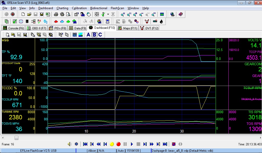

Originally Posted by
THEFERMANATOR
The 01 OS's don't have it mapped out, pretty sure all of the 02+ have it. If you're still not getting lockup in 2nd after you have changed the slip limit tables, go in to D5064, and lower the speed down for the lockup speed by 2-3 MPH or more, that should get you lockup. Even if you change the slip limit, you have to have the lockup speed low enough that there is a buffer between the 2-3 shift and the lockup speed, otherwise it won't lockup regardless of the slip limit settings.
