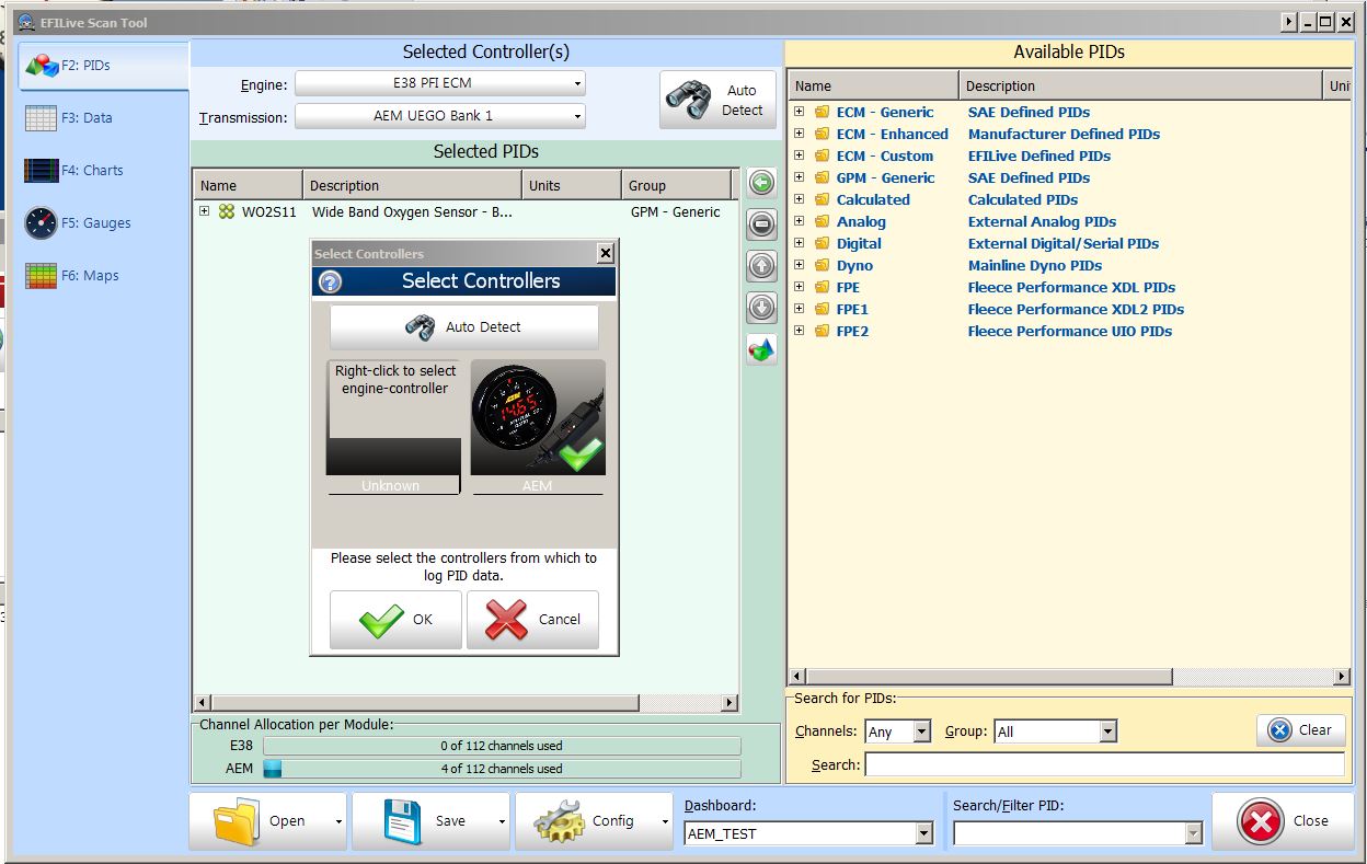

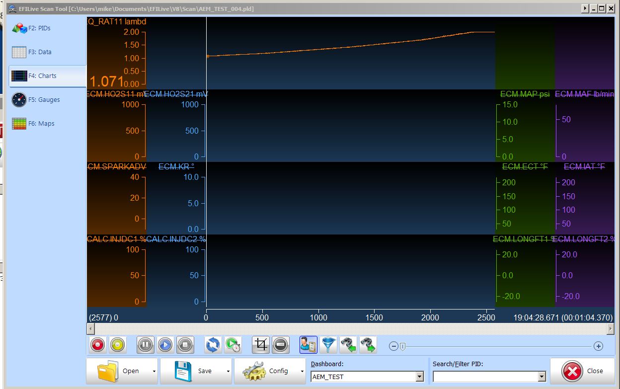

Initial testing with the re-flashed AEM 30-0333 and the new beta FlashScan v8 shows everything to be working, as designed. I was able to record several logs with the OBDII lambda data. Recorded data matches the gauge display to 0.001 lambda at the maximum sample rate.
If you would like to try, you will need the new beta EFILive software ( ver 8.2.3.305 ) and a re-flashed AEM 30-0333 wideband ( fw ver 1.13 ). I will be doing the re-flashes for the widebands, during the beta test period.
AEM 30-0333 controller auto-detected. Using the trans controller slot.

Sensor drifting from Lambda 1.000 to free-air, in test chamber.
