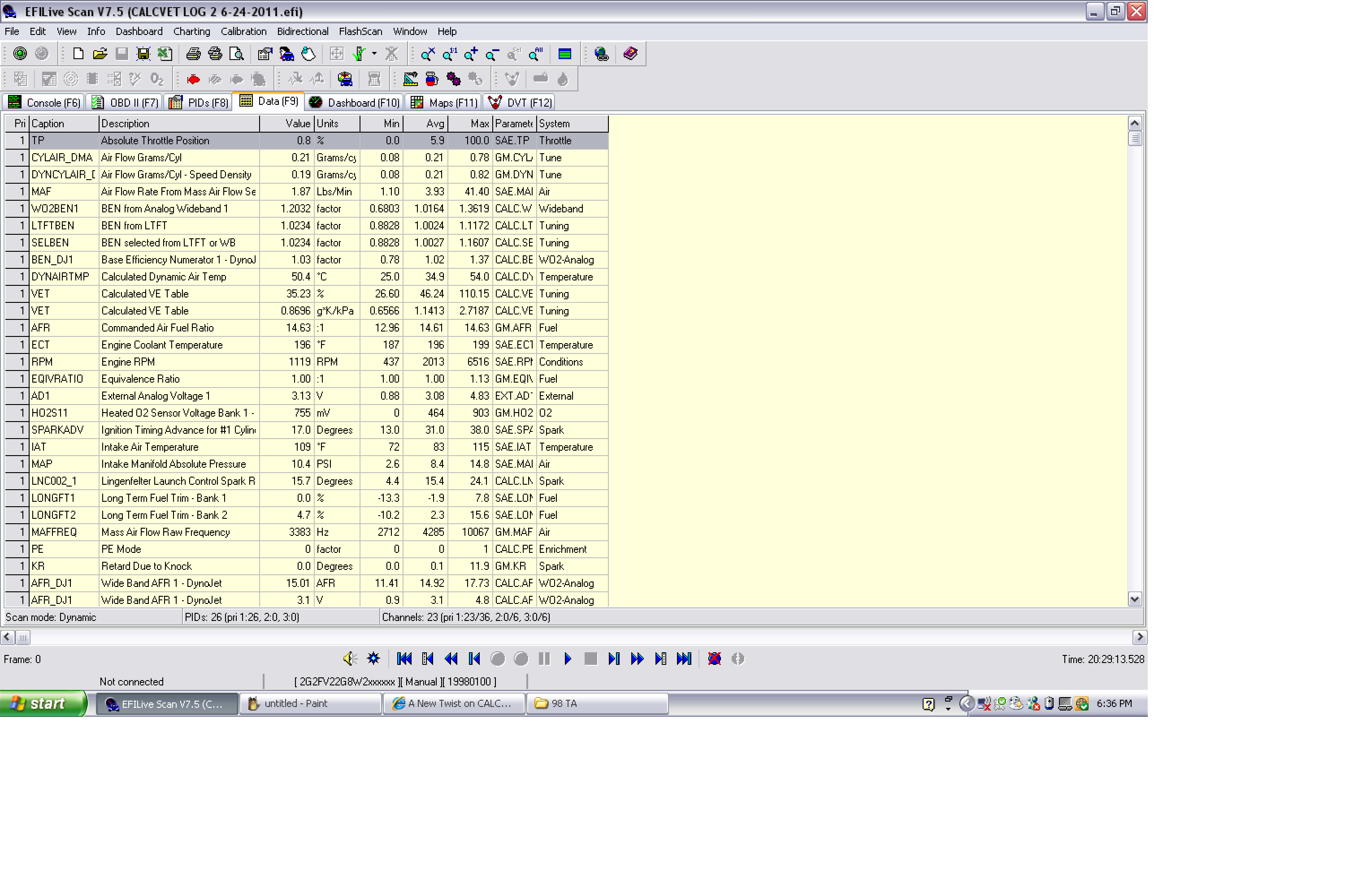

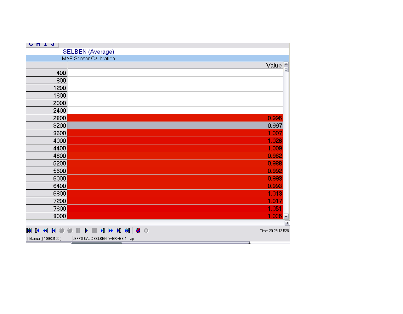

Frozen:
On your SELBEN Map..if you could change 'Cell Count' to 'Average Value'..that will allow us to see the actual data..

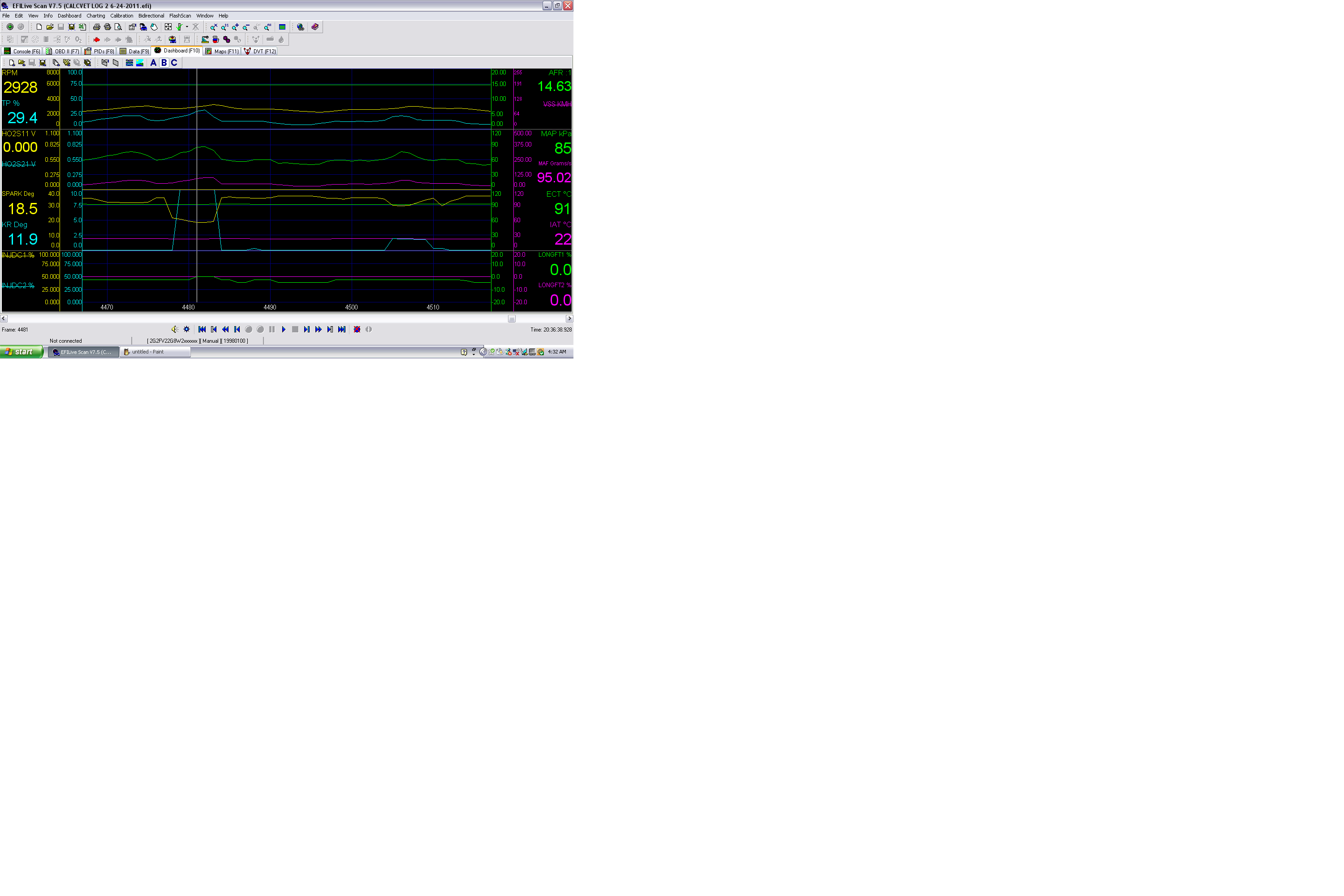

I see you had a max of 11.9 degrees of KR. Whats going on there?

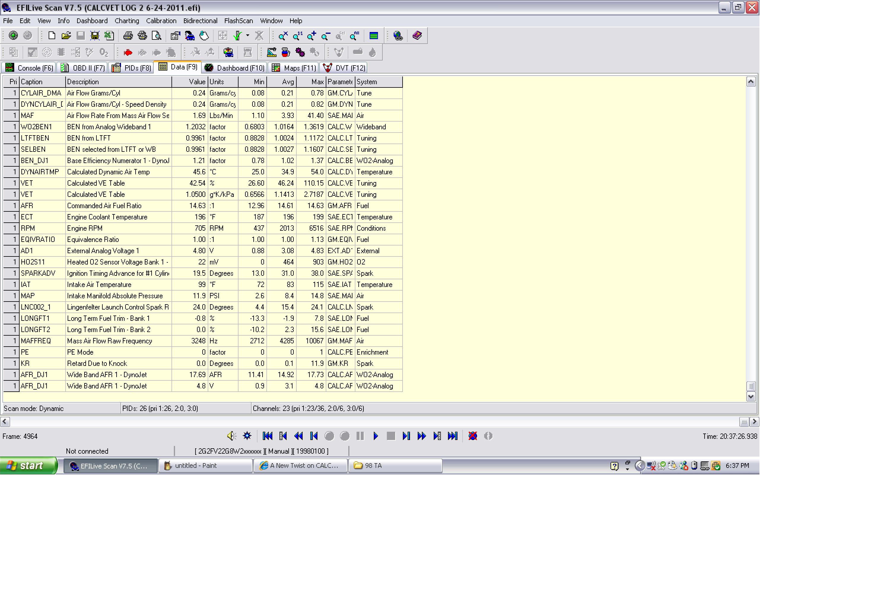

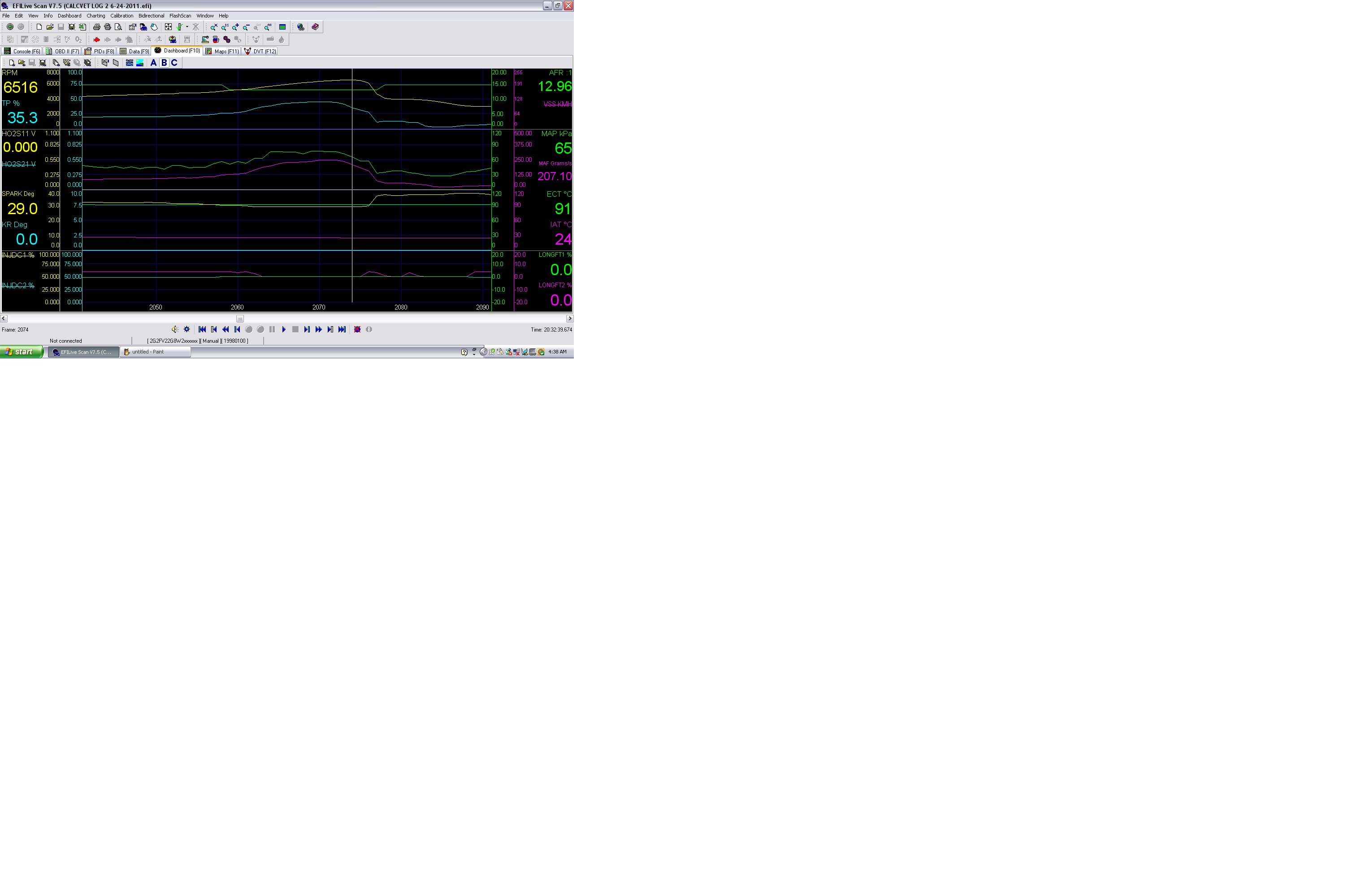

3 Attachment(s)
I usually get knock at low rpms, mostly idle. But that was the first time I've seen so much. I think it's my coil. So I'm going to swap one off of my WS6 and see if it clears up. Here are a couple of other scans of the knock area and the upper rpms. Also I switched the Selben to averages.
Attachment 11241Attachment 11242Attachment 11243
Your scantool still has MAP in psi units (you want kPa)...
on PIDs tab: on SAE.MAP do rightclick->Metric.
Also: for maps A and B, in map properties goto each tab Data, Row, Col and checkmark Show Units and save the map.
Also, I don't see the pid CALC.VEN... you're using an older calc_pids.txt file.
Also, Frozen is your SELBEN Table plotting vs MAF frequency or RPM?
At some point it might be easier to just attach the Log with all the MAPS you used.
I have a feeling their are some issues here that might not allow you to use this log..
