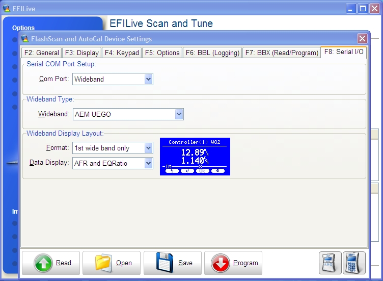

Did you set the wideband type to AEM?
Attachment 7938
Attachment 7938
yes i set the wide band to AEM UEGO

i noticed some thing weird when i tried to calibrate the FS V2 settings as in the
Serial Wideband Tutorial i did not get the COM In : WBO2 and COM OUT : WBO2
as in this picture is this because i have the latest version of the firmware
http://img40.imagefra.me/img/img40/6...2m_02534e4.png
Yes, the latest firmware has change that, the doc has not yet caught up.
