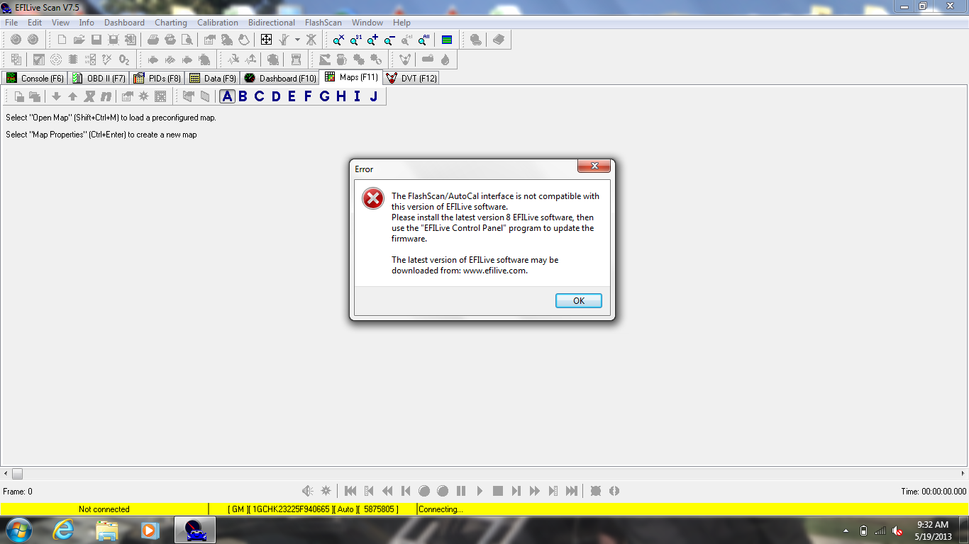

This is all I get when i try to connect with my scanner or V7 tune tool. i used V8 to DL a LBZ tune this morning and that worked fine. But I have done the latest update and made sure the firmware is updated and nothing is working right. I guess from now on I will not be updating my V2 anymore once I get this working again. i have spent the last 3 hours reading and updating and trying different USP drivers to try to get this to work. and it seems to be that everytime I update my V2 this happens. very frustrated with all of this and I have a couple duramaxs to tune this week and would really like to be able to use the scan tool. Any ideas?????
Ok so once again i had to use the "OLD" drivers to get this to work even though in the USB drivers post we were told to NOT go back to the old ones. so just to see if it would work i ran as admin the usb drivers manager and did the old ones and it works fine now......

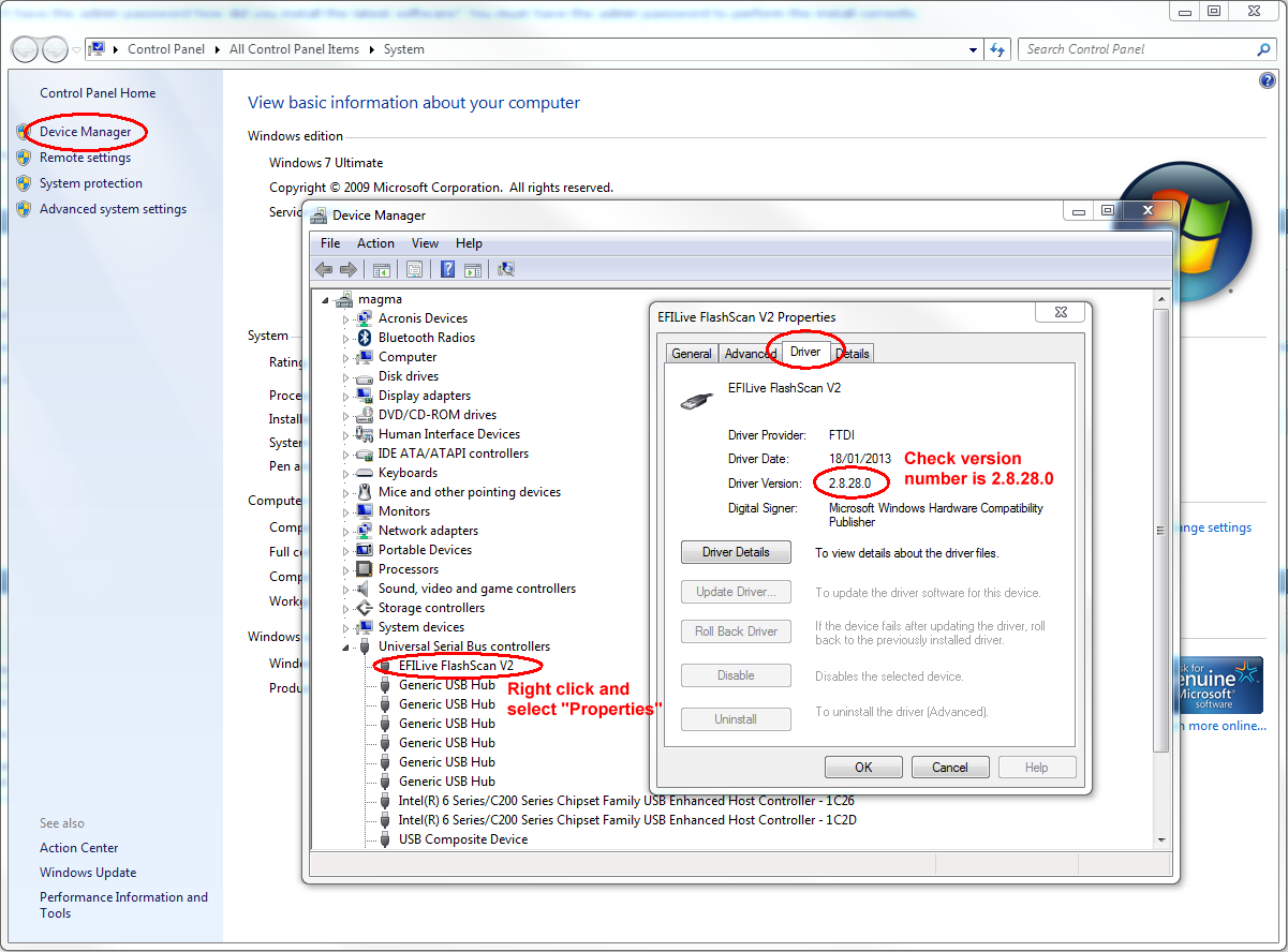

Check that the drivers have been installed correctly by right clicking on Start->Computer and selecting "Properties".
Select "Device Manager" and expand the "Universal Serial Bus Controllers" item.
Locate the FlashScan item and right click it and select "Properties", then select the [Driver] tab page and check that the version is V2.08.28
Attachment 15089
If the drivers are not correct, use the EFILive USB Manager program to install the latest drivers. You can run the latest version without using the "Run as Administrator" option. The latest version automatically checks to see if you have admin privileges and uses them if you have.

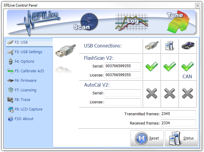

Once the drivers are correct, check connectivity by running the program: Start->All Programs->EFILive->V8->EFILive Control Panel.
A small FlashScan icon will appear in the System Tray at the end of the Windows Task Bar near the clock.
Click on that icon to open the EFILive Control Panel.
Click the [Status] button to see if the control panel can communicate with FlashScan. It should look something like this. You should have at least 2 green ticks.
