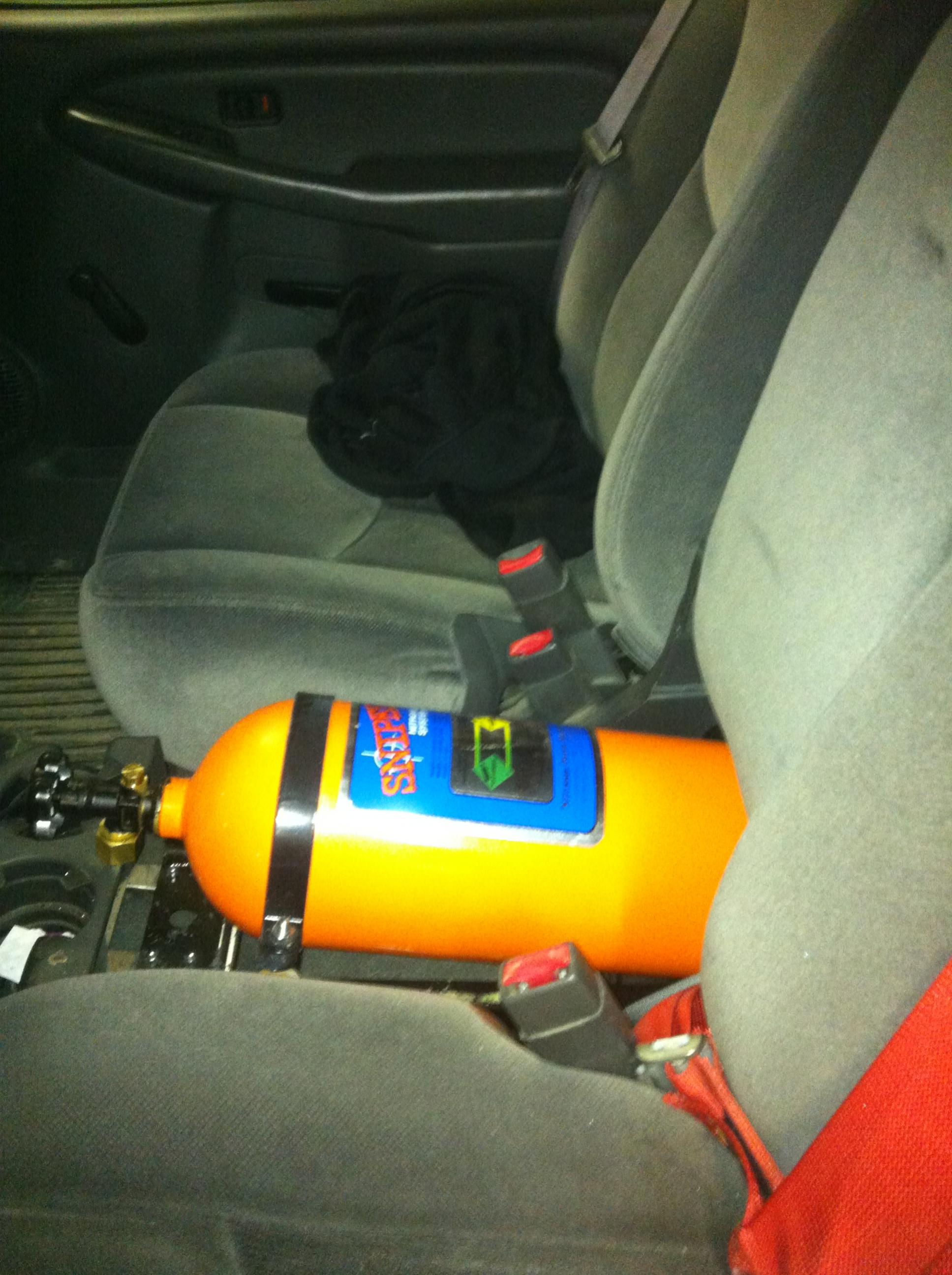

2 Attachment(s)
Here is the sneaky spot i put my bottle. :sneaky::laugh:
