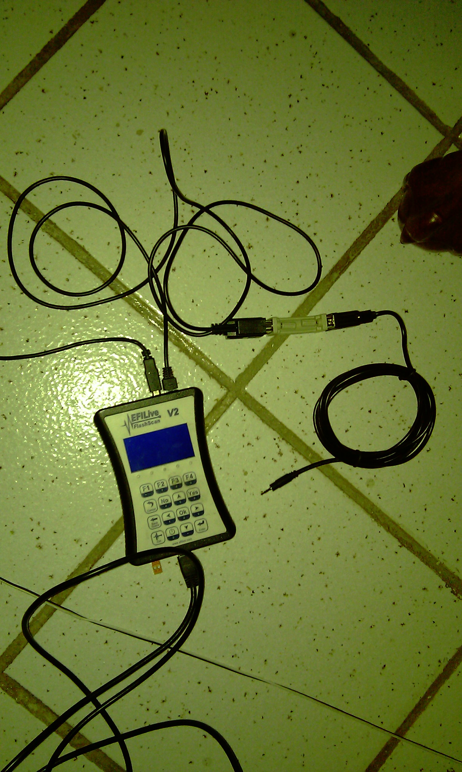

I circled the terminator plug in red in the attached image.
Edit: Joe, your picture is much better :)
lol... I think I overdid my pic... :hihi:
I love you guys :)
I can't believe that this little dead end plug is whats needed to make this work. It doesnt make sense to me, but what do i know. As soon as i plugged it, the 2nd from left orange light started blinking every second.
It is working at laaaaaaaaaaaaaaaast. I drove around and the AF was perfect showing mid 12's under WOT.
Thanks a bunch for all the help. Really appreciate it.
Is this wiring right or wrong if it wrong so can you show a correct onehttp://forum.efilive.com/attachment....6&d=1278553107
Is that a null modem or a gender bender?
A null modem is needed.
That little plug is detected by the LC1. As soon as it detects the plug it starts transmitting the serial wide band data. If it does not see the plug then it does not transmit the data.
I'm pretty sure it has something to do with the LC1's ability to be daisy chained with other LC1's. Each LC1 in the chain waits for the previous LC1 to transmit its data, then it appends its own data to all the previous LC1s' data.
So basically the furthest away LC1 needs to be "told" not to wait for any other previous LC1's data (since there is no further LC1 in the chain) and to just transmit its data, to which all the other LC1's will append their data as the data makes it way back to FlashScan along the chain.
If you only have 1 LC1, it doesn't know its the only one and therefor the furthest one and that it should just transmit its data and not wait for another (further away) LC1 to start transmitting. The only way to "tell" it that information is to plug the loop back dongle into its serial cable.
That's my understanding it could be wrong, the guys at Innovate would know more...
