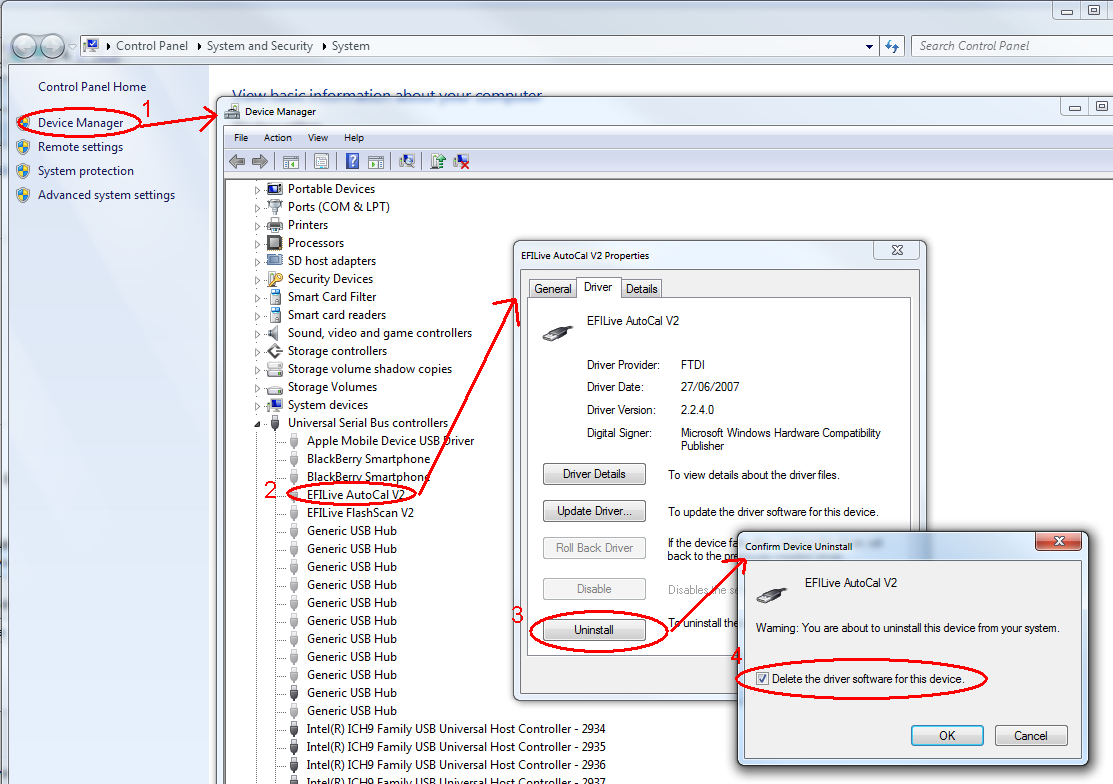

Open the Windows Device Manager and uninstall all FlashScan/AutoCal devices with the option to delete driver software.

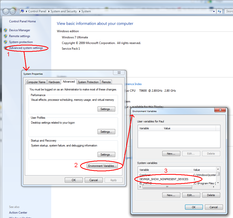

If you don't have FlashScan/AutoCal connected, you can still see/remove the drivers if you set the environment variable:
DEVMGR_SHOW_NONPRESENT_DEVICES=1 before opening the Windows Device Manager. And select the device manager menu option: View->Show Hidden Devices.
