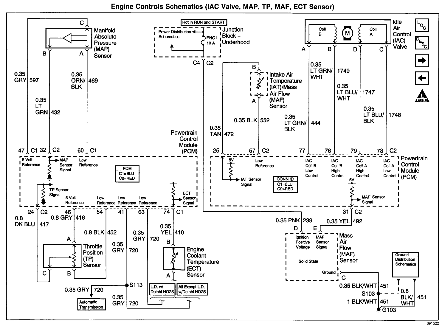

Ok i will do that. I searched the forum for wiring in the iat but came up short, would you happen to know what wires they would be? or where i couLd get the info on wiring?
No, I don't know which ones. I would search over on LS1tech or try to find some wiring diagrams for the truck (google). One other thing - need to do the "configuring a 2 Bar MAP sensor" on page 14 of the COS tutorial.
Hey do i need all 4 02 sensors to go mafless or just upstreams?
Tan wire and black wire are for the iat. Here is a diagram for anyone looking. Attachment 13290
