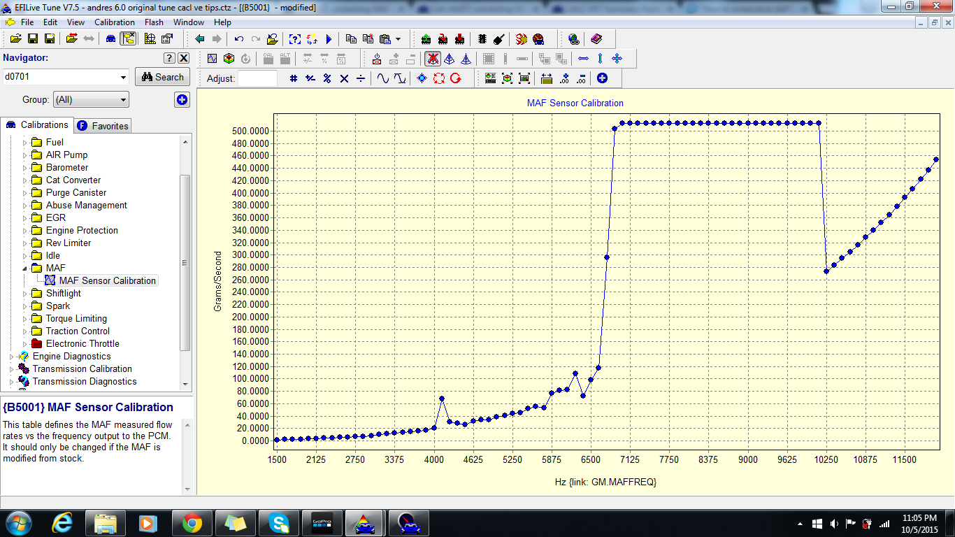

My bad I didn't specify that the corrected table for maf is wanting to max out the maf around 4500rpm
Post a screenshot (SHIFT-PRTSCR and save to .png file, post .png file).
Attachment 18897
my first time to screen shot something sorry it took so long.
Something wrong with your data there zayne0.
Maybe paste your log and tune files.
+1 what darcy said...
EXT.WO2LAM1 is stuck at 28.5...
which wideband do you have...?
CALC.DAT is jumping alot... and maybe it's too high.
What elevation are you at...?
I'm at 3200 ft.
